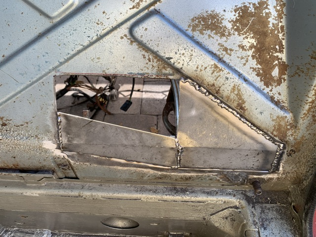

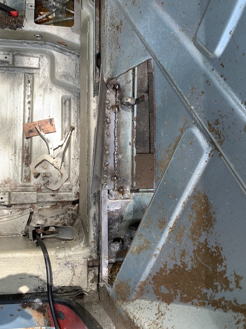

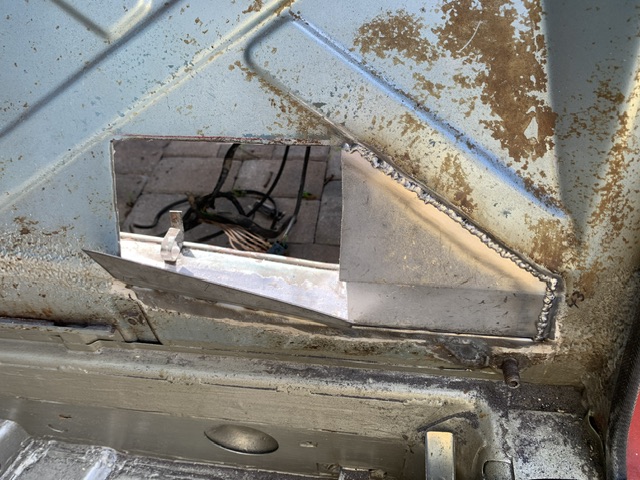

seanpaulmc   Need a waterproof car cover. Thought this was fine...   Aug 31 2024, 06:24 PM
seanpaulmc   Hot! No rain today. Welding could be done. :...   Aug 31 2024, 06:31 PM
930cabman   Hot! No rain today. Welding could be done. ...   Sep 1 2024, 05:22 AM
seanpaulmc   Hot! No rain today. Welding could be done. ...   Sep 1 2024, 01:56 PM
seanpaulmc   Got the rest of it in just before the heavens brok...   Sep 1 2024, 02:01 PM
