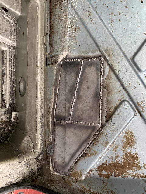

Got the rest of it in just before the heavens broke loose. It is pouring rain in the sunshine state.
Didn’t even have a chance to get the grinder out.
