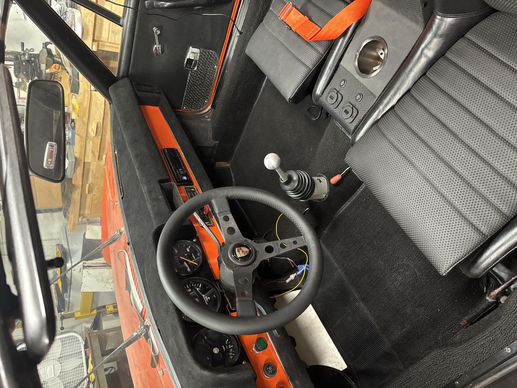

started the process of fixing the dash cracks. Using bondo with fiberglass, then skim coat of regular bondo. will be flocking this weekend. There is a corresponding portion of the metal dash component that will be flockled as well.

Here is the dash back in the car. Vacuuming the dash is no problem. Holding up well with all the in and out and all the rubbing up against itAttached Image

drdriddle   Did the metal part of the dash last night. This is...   Feb 23 2024, 04:11 PM
drdriddle   Also did a glovebox delete. Couldn’t get it to l...   Feb 23 2024, 04:13 PM
burton73   Are you using a flocking gun and slow dry BK ename...   Feb 23 2024, 05:02 PM
drdriddle   Yes it’s a flocking kit. It’s a brush on self ...   Feb 23 2024, 08:45 PM
drdriddle   Well here is the dash pad… I think it looks awes...   Feb 24 2024, 05:22 PM

Krieger   That looks really good! Are you going round d...   Feb 24 2024, 06:16 PM
windforfun   That looks really good! Are you going around...   Feb 24 2024, 06:24 PM
drdriddle   Ahhh, actually I did an ashtray delete as well. Ho...   Feb 25 2024, 12:53 AM

drdriddle   So the big questions are the time and money. The t...   Feb 26 2024, 01:03 AM

drdriddle   Here is the dash back in the car. Vacuuming the da...   Sep 1 2024, 09:09 PM
drdriddle   Different angle   Sep 1 2024, 09:14 PM
drdriddle   Btw, I would rather remove my own eyeballs with a ...   Sep 1 2024, 09:25 PM

drdriddle   Here’s the center divider. Seat heater controls ...   Sep 2 2024, 10:14 PM
