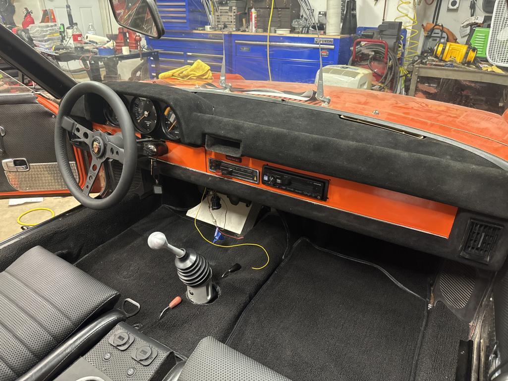

started the process of fixing the dash cracks. Using bondo with fiberglass, then skim coat of regular bondo. will be flocking this weekend. There is a corresponding portion of the metal dash component that will be flockled as well.

Different angleAttached Image

Btw, I would rather remove my own eyeballs with a rusty knife than put the heater control system back together again!!

drdriddle   Did the metal part of the dash last night. This is...   Feb 23 2024, 04:11 PM
drdriddle   Also did a glovebox delete. Couldn’t get it to l...   Feb 23 2024, 04:13 PM
burton73   Are you using a flocking gun and slow dry BK ename...   Feb 23 2024, 05:02 PM
drdriddle   Yes it’s a flocking kit. It’s a brush on self ...   Feb 23 2024, 08:45 PM
drdriddle   Well here is the dash pad… I think it looks awes...   Feb 24 2024, 05:22 PM

drdriddle   So the big questions are the time and money. The t...   Feb 26 2024, 01:03 AM

drdriddle   The kit I used was from https://www.flockit.com/or...   Mar 3 2024, 11:01 PM
drdriddle   The underdash pad is ready for flocking…proba...   Mar 3 2024, 11:03 PM
drdriddle   Here is the dash back in the car. Vacuuming the da...   Sep 1 2024, 09:09 PM
