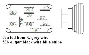

I am running an alpine radio that has a dimmer function wire. It hooks somewhere, I assume, into the headlight switch. This should allow the radio illumination to match the dash light illumination when the headlight switch is pulled on. I know the headlight switch has a rheostat that controls the light output for the dash but the switch itself has multiple poles off of it and i have no idea if one of them is responsible for what im looking for.
Anyone have any ideas? the wire diagrams i have in the hayes manual are very small and don't really help please and thank you |

Well this is pretty easy, at the rear of the switch are two terminals for the rheostat (right next to the terminals). One of those terminals is the input, and the other is the output. Get a piggyback splitter, and put it on the output, then the original wire on the splitter, and the new wire on the splitter.

87m491 Grab your DVM and ground the negative test lead, t... Sep 3 2024, 03:25 PM
Spoke @drdriddle
The dimming wire from the headlight s... Sep 3 2024, 05:27 PM
JeffBowlsby Yes, connect to any black/blue stripe wire in the ... Sep 3 2024, 06:06 PM
Spoke You can use one of these piggyback spade connector... Sep 3 2024, 06:07 PM![]() ![]() |
