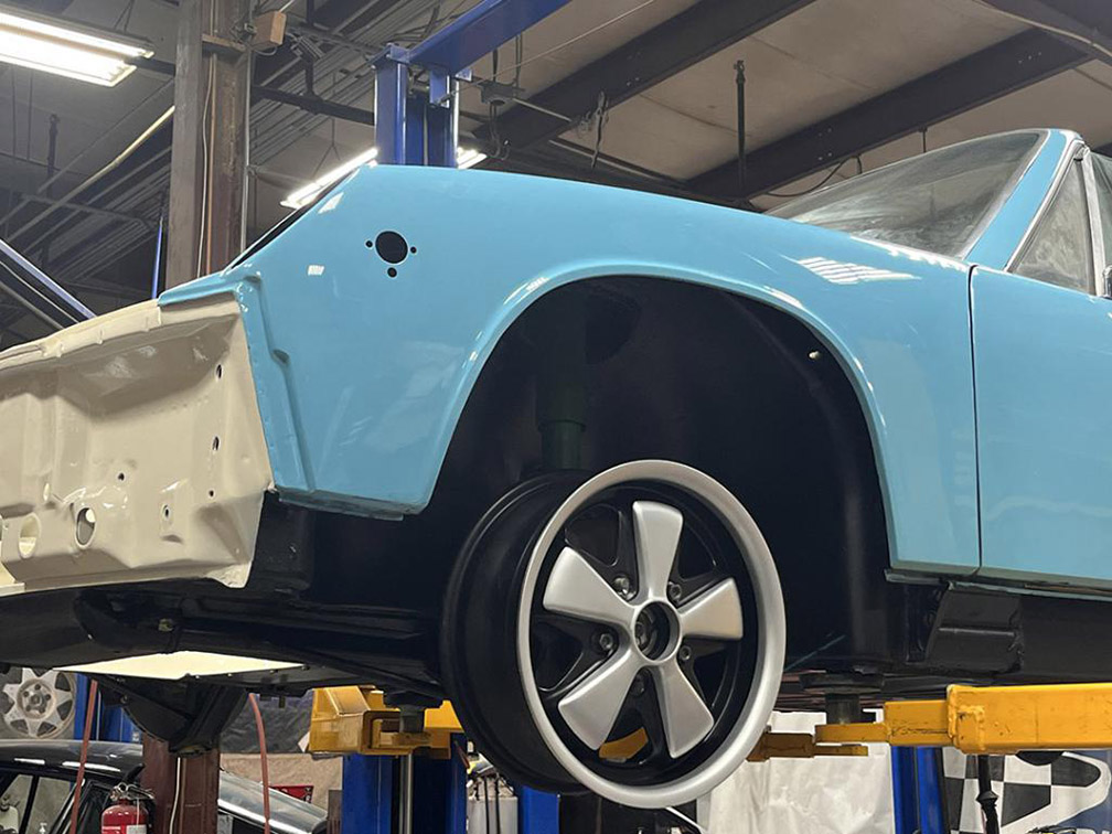

As far as the wheels go, these are the wheels my life long bud Mark Sonners is runny on his stock body 914 (the blue one that was mine for the last 20 years) with just the rear lips flatted (roiled). The wheels are deep 6s sixes and 7Rs nice copies. On the 7Rs the extra 1 inch is on the inside so the outer face is just like a deep 6. I can not find the tire size right now in my postings.
I love the way these came out. Wheels were supplied by PMB Performance (Eric) can make you a fair deal on the wheels. As my grandfather used say, (a phone call starts a deal)
Car runs Carrera front suspension and a 85 Carrera steering ZF rack, Rears are 914-6 reproduction rear calipers
