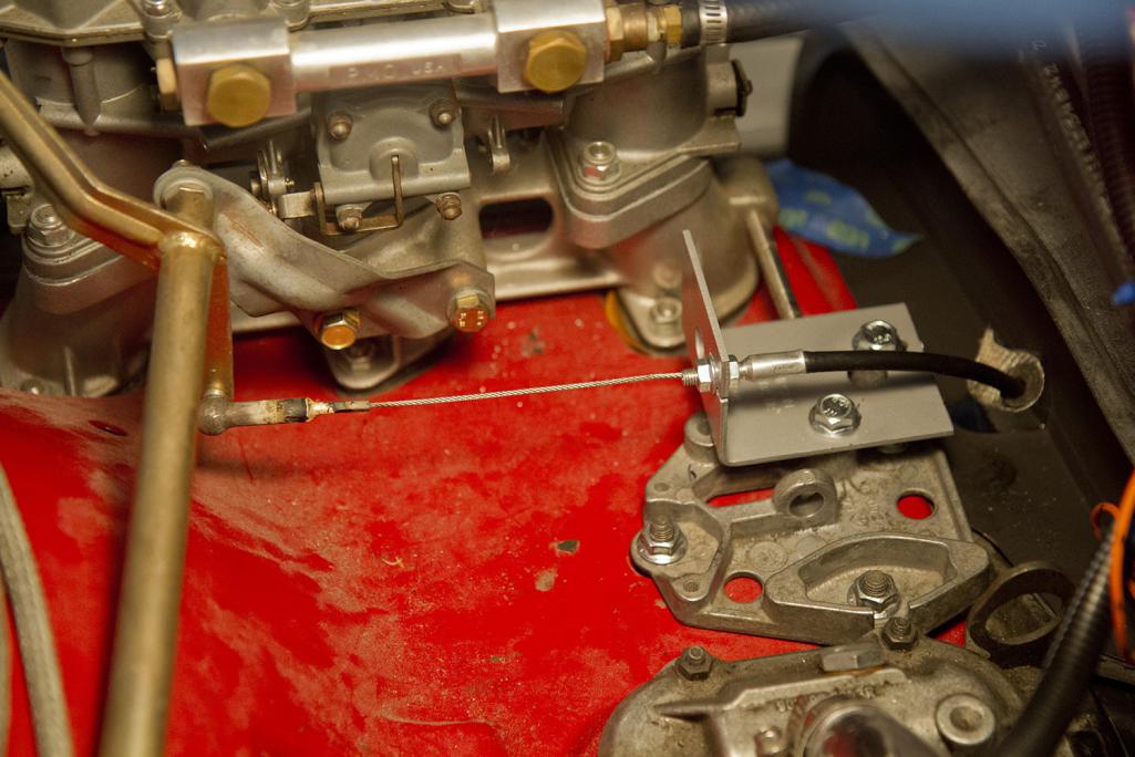

I understand the fuel pumps needs to be matched to the engine and will fit in the 75-76 front fuel pump acces cover (IMG:style_emoticons/default/smile.gif) . Does the tunnel lines need to be larger? I have the SS ones already and was hoping to reuse.
Accelerator cable, it looks like patssle (hasen't logged in in two years (IMG:style_emoticons/default/sad.gif) ) figured a way to just loop ~180 degrees is /4 cable and brought it in trough the bell crack rod opening in the tin (picture below). Seems like getting the cable directly to the TB would be the simplest, lightest, cost effective way to do it. (IMG:style_emoticons/default/confused24.gif) That being said, it doesn't look like his setup is a 3.2 but still...

The factory linkage for a 914-6 works with a 3.2. The 914-6 cable linkage was setup to adapt the 911 linkage to the 914-6 mid engine layout.
Easy enough to do and it uses all factory parts.

I understand that, but it seems like a lot of pivot points for something a properly routed cable to the TB could do. (IMG:style_emoticons/default/confused24.gif)
I see Rich Johnson seels a replica of all this but, starting from nothing, this adds up to ~$500 to route a bycicle cable to a point. (IMG:style_emoticons/default/blink.gif) Seems over engineered to me. I will look at the various options once I cross that bridge. patssle did it with a simple aluminum bracket, maybe others have found other ways too. (IMG:style_emoticons/default/smile.gif)
