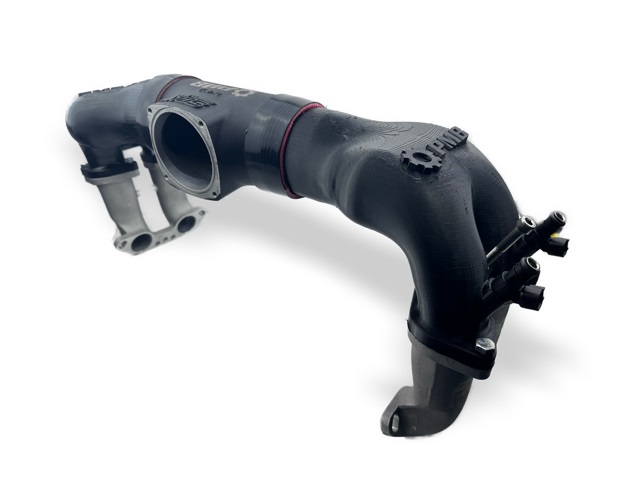

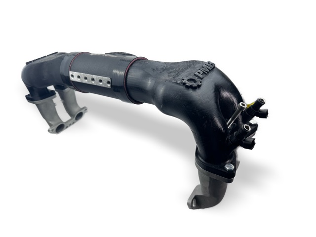

The stroker 2258 builds have amazing hp. All with modern EFI. The new intake is wrapping up. We'll begin testing next week. Sneak Peek here first.
^ This look fantastic! (IMG:style_emoticons/default/smilie_pokal.gif)
