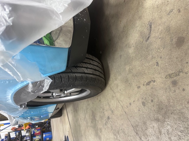

The "Deep Six" and "7R" is "the" wheel fitment for a narrow body super car. the offset on the face is identical so the 7 in the back looks just like the 6 up front. We have the same tires on the above car that I have on my RS pictured below. 205 up front and 215 in the back.

Been thinking about having my deep six rears widened to 7Rs, and this pretty much seals it. Tire package on your 911 looks fantastic—what tire are you running that's 205 & 215?
It's time for tires, and there very few interesting choices for a narrow 914 if you want to stagger the tires. Have been mulling 185/70R15 P6000 for the 15x6 up front with 195/65R15 P6000 for the 15x7 rear. Not as nice as running 215 rears, but looks like it'll go in a lot easier and I can always play with the fenders later.

Stay Deep 6 up front and go 7R in the rear. Mark bought Falken 205/60-15's for the front and 215/60-15's for the rear. There is a 1/2" spacer under the rear wheels to get them off the inner fender well. Fenders are rolled and "ever so slightly" pulled. Not noticeable.

P.S. Car is back for some RRC tuning. 215 on 7R look...
