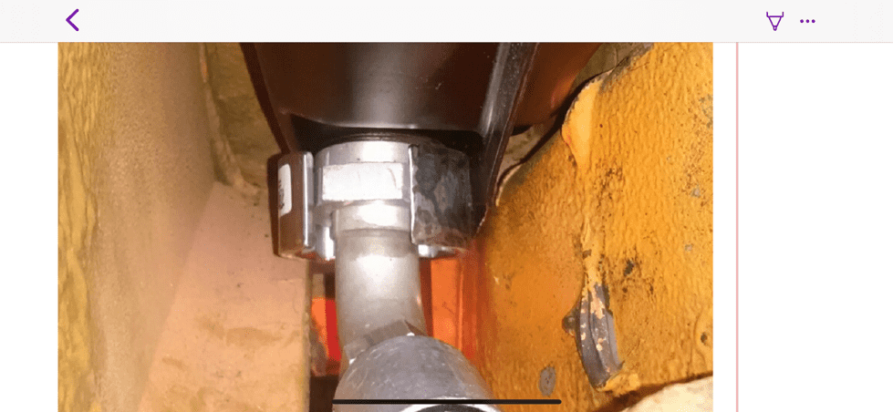

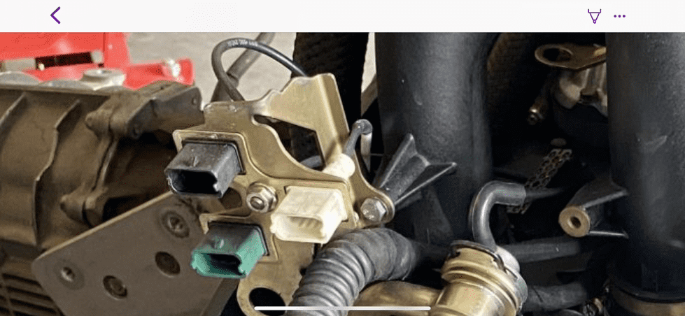

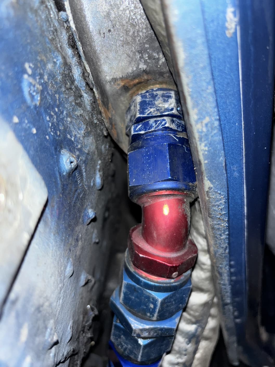

Getting close. Drive train in car. Oil line leaking from bottom of tank. Going to replace fitting that's easier to tighten. The rest is just bolting on the axles, shift linkage, cables and exhaust. Slowly, but surely. I did have to cut clearance a couple of things rubbing on trunk and oil line rubbing on tin, but no big deal. I will add more pictures as I go.
Had to cut right above the sensors to not hit trunk. Not my picture, but same outcome.
Current oil line
New line, not my picture but similar. I also have the same crows foot that I need to grind down to fit.

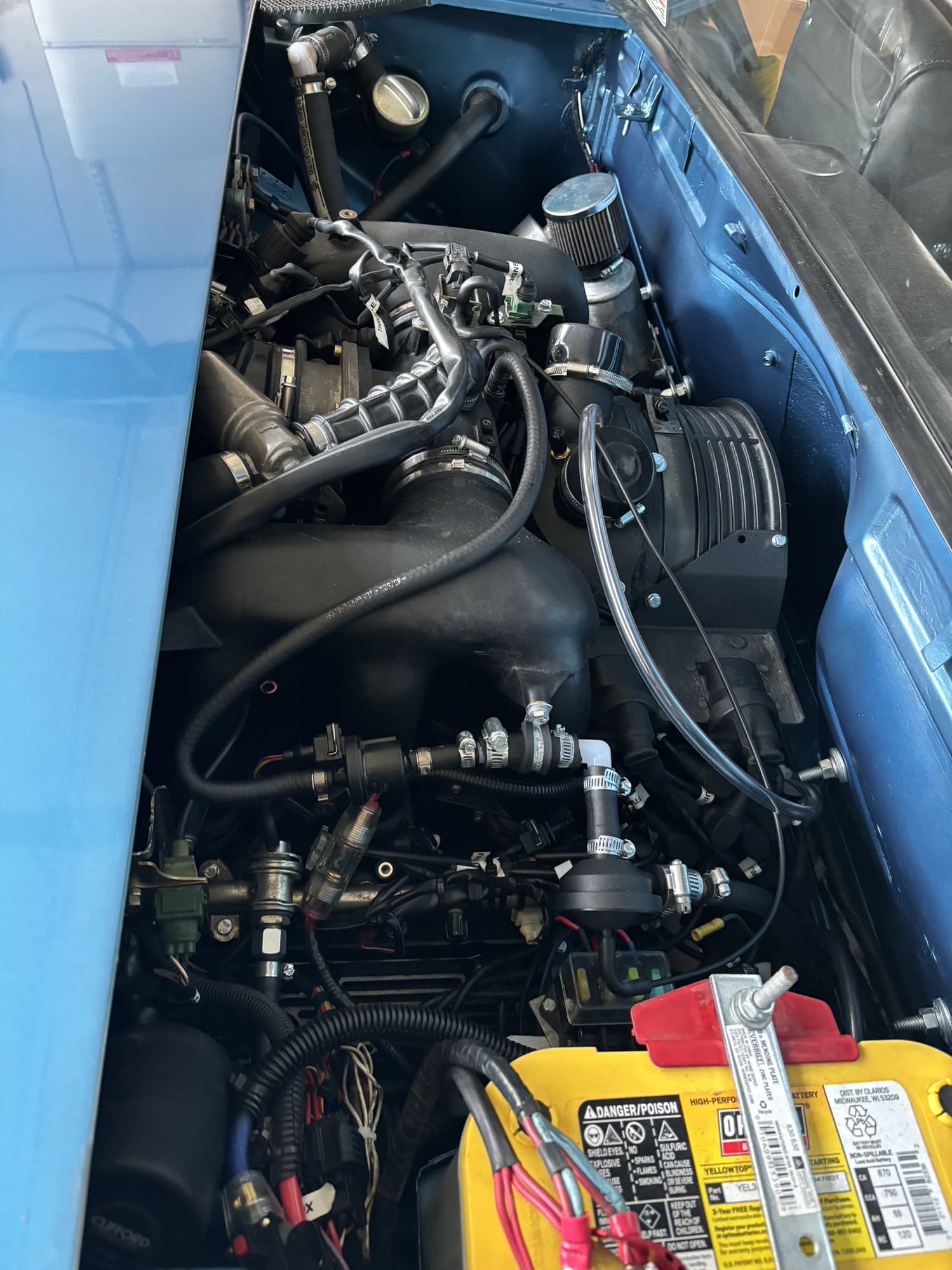

Steve   Finally semi got the car together, but it won’t ...   Sep 23 2024, 06:40 AM
