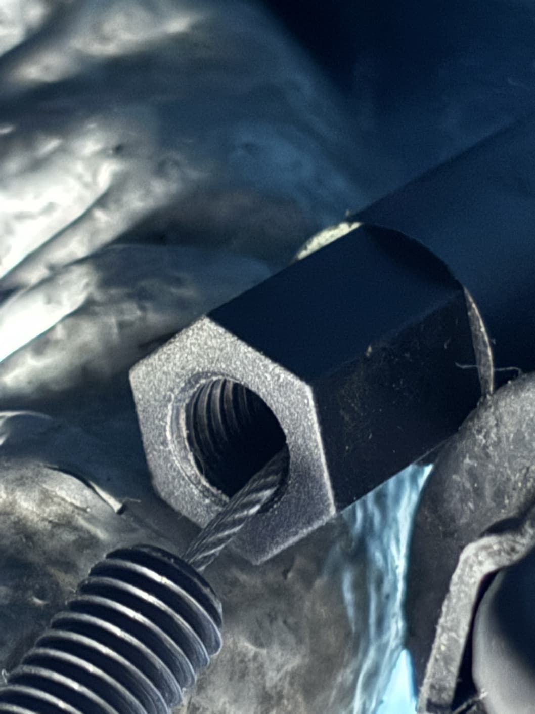

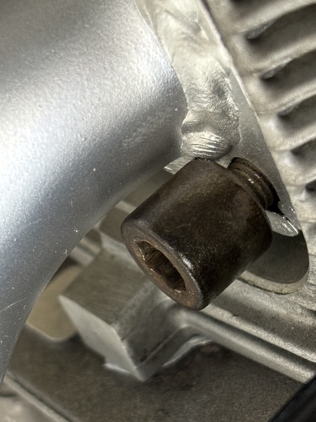

Welds too thick on the MSDS 1 3/4” headers. PIA, but have to grind down every weld, just to clear a standard nut or barrrel nut.

Steve   Welds too thick on the MSDS 1 3/4” headers. PIA...   Sep 16 2024, 10:25 AM
Steve   Here’s my Home Depot Motorsports solution to tak...   Sep 20 2024, 01:51 PM
