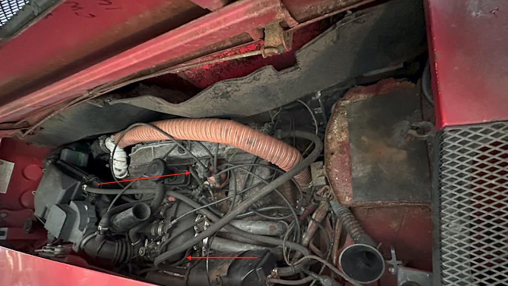

this is the hose i am talking about connected to the throttle body upper port and the vacuum advance can on the distributor. see attached photo arrows.
in photo you posted at start it looks like its continuous to throttle body from distributor can.
but you know what i could be wrong looking hard at the photo.
its possible the other end i am looking at is the hose from the fuel pressure regulator over on left side of engine.
normally the hose from the distributor can is laid over the top of the inlet plenums and up to the throttle body. this one is tucked under on yours.
its entirely possible that its actually an EC-A still in original condition.
if so that hose from distributor can is just tucked under the inlet plenum near the distributor and has been left open which is what the factory did.
if thats the case then the throttle body has no port on the back side of it (ie facing rear of car). be interested to know. if a) the port is there and has a plug capping it or b) no port at all. have a look when you get some spare time. its just that there are so few intact EC-A cars to know what was actually done by factory. your car might just have the original set up. if it does we can set it on the record. (IMG:style_emoticons/default/beerchug.gif)
