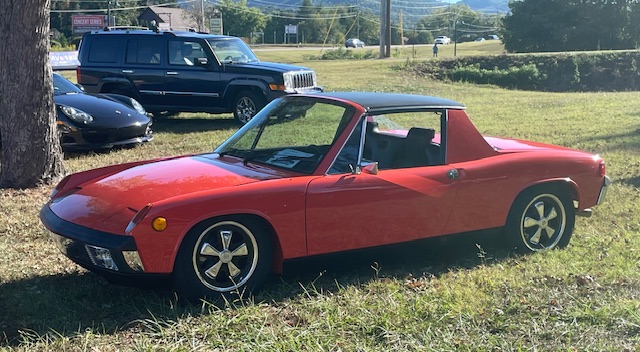

Well I got the 914/6 done enough to bring it to Okteenerfest. Still have a few things to finish on it. But it was there.

QUOTE(bam914 @ Sep 18 2024, 04:22 PM) *
(IMG:style_emoticons/default/piratenanner.gif) Great accomplishment, got to feel awesome
