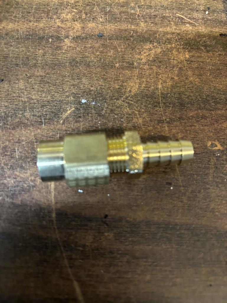

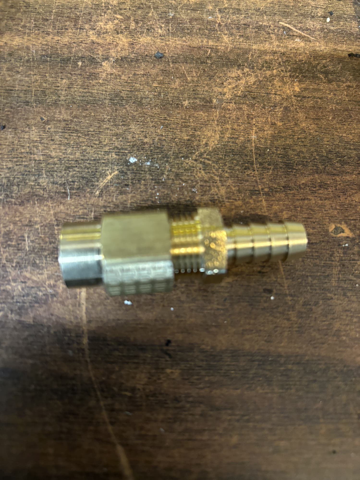

Here’s my Home Depot Motorsports solution to take up the extra cable slack for the accelerator cable.
