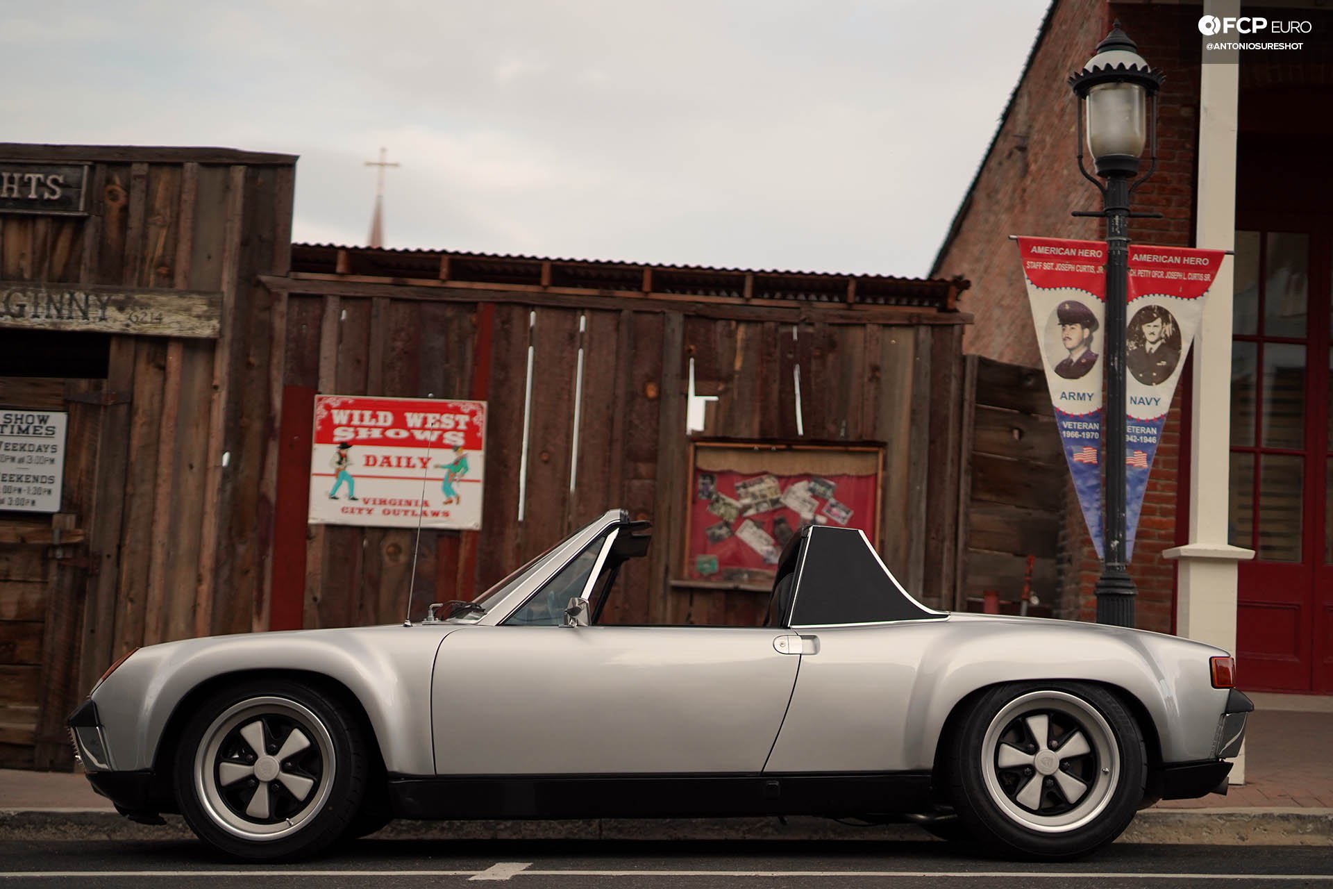

I think the sweet spot for the 914 is a 3.2L /6 with FI, it just feels like they all should have come with one. It's a perfect fit to the car.
PS: And for a street driven 914, the 3.2L doesn't need a front mounted oil cooler, the stock oil cooler works just fine.
