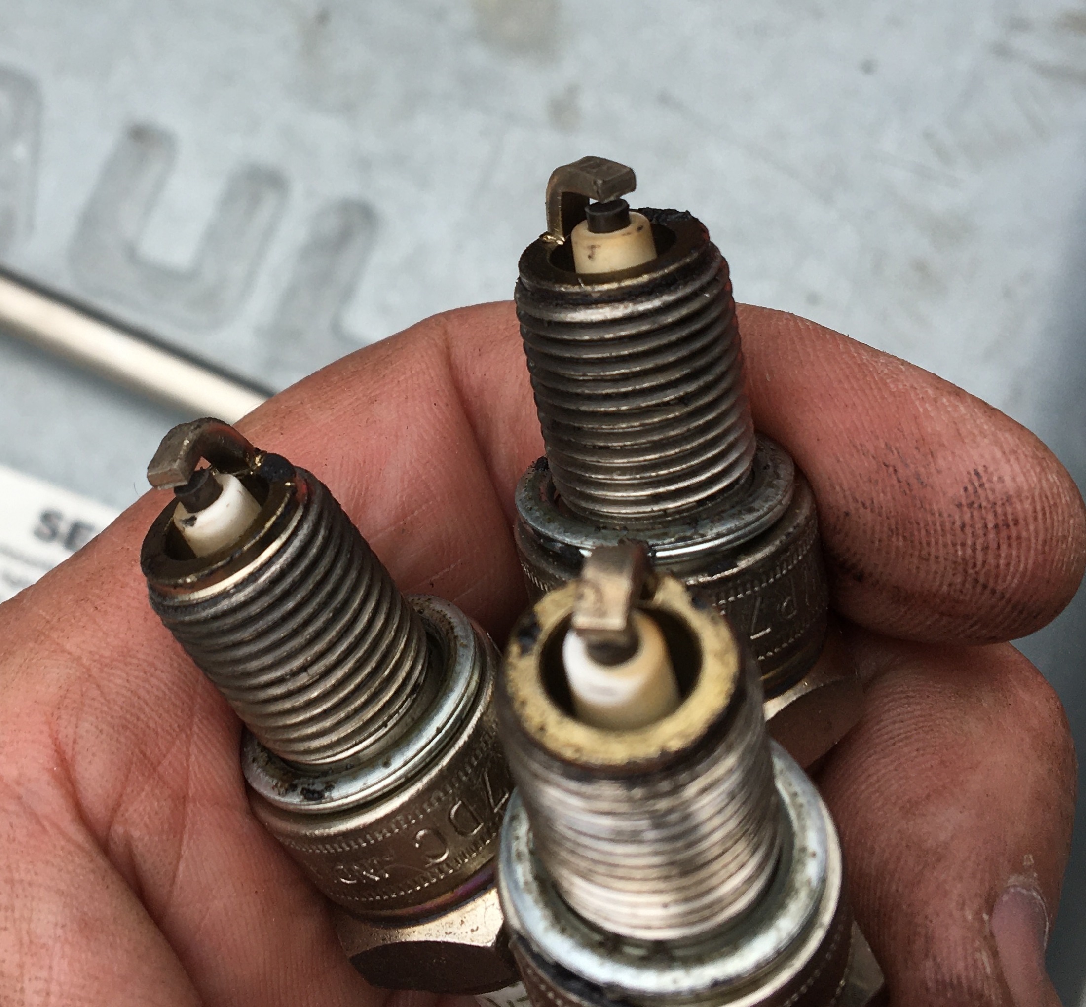

Quick update to share that yes, I got the 3.2 with a bunch of nice goodies, many of which I will be seelling as I have equivalent or simply will not need them.
I want to thank you all for the great inputs. As for the very few that suggested the big /4, I am a little sad that I will not be building this engine. After having buit my 2056 a few years back, I was really looking forward building it.
So the /6 conversion starts! Well, that is after I get everything sorted in my garage... (IMG:style_emoticons/default/wacko.gif)
You will be able to follow it in my build thread here in a while... (IMG:style_emoticons/default/rolleyes.gif)
http://www.914world.com/bbs2/index.php?sho...=349463&hl=

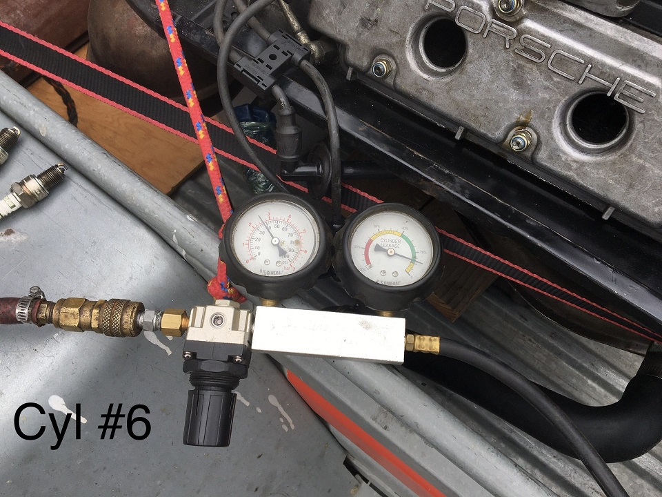

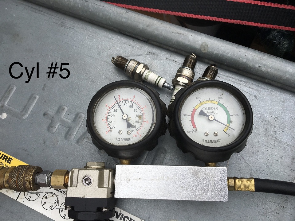

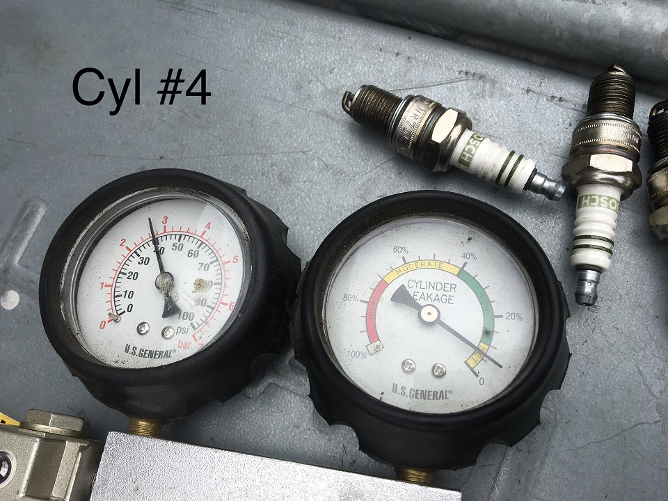

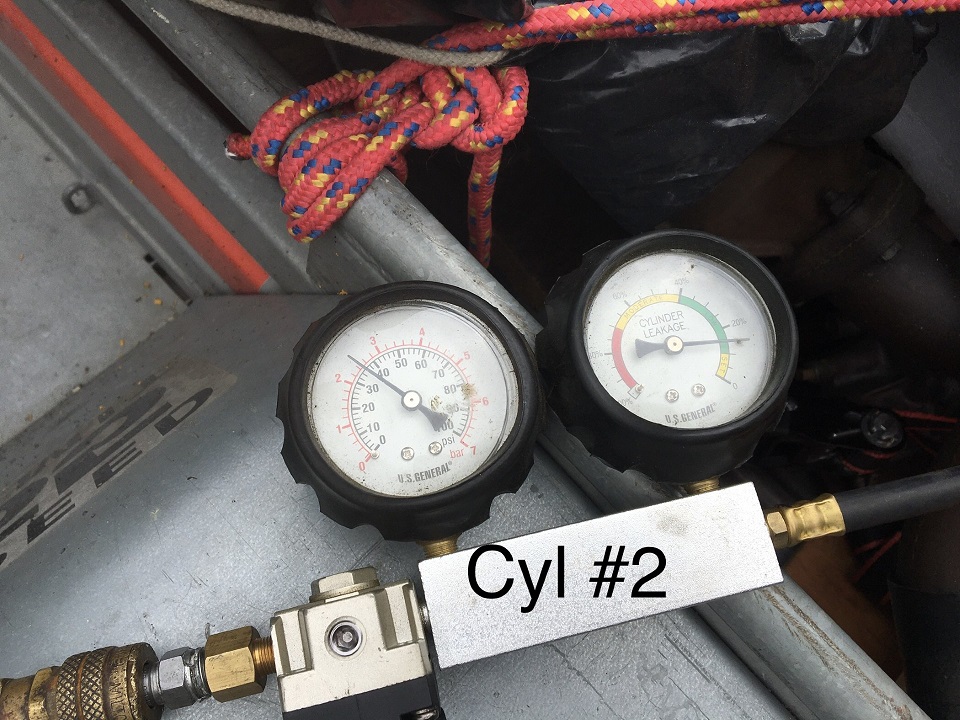

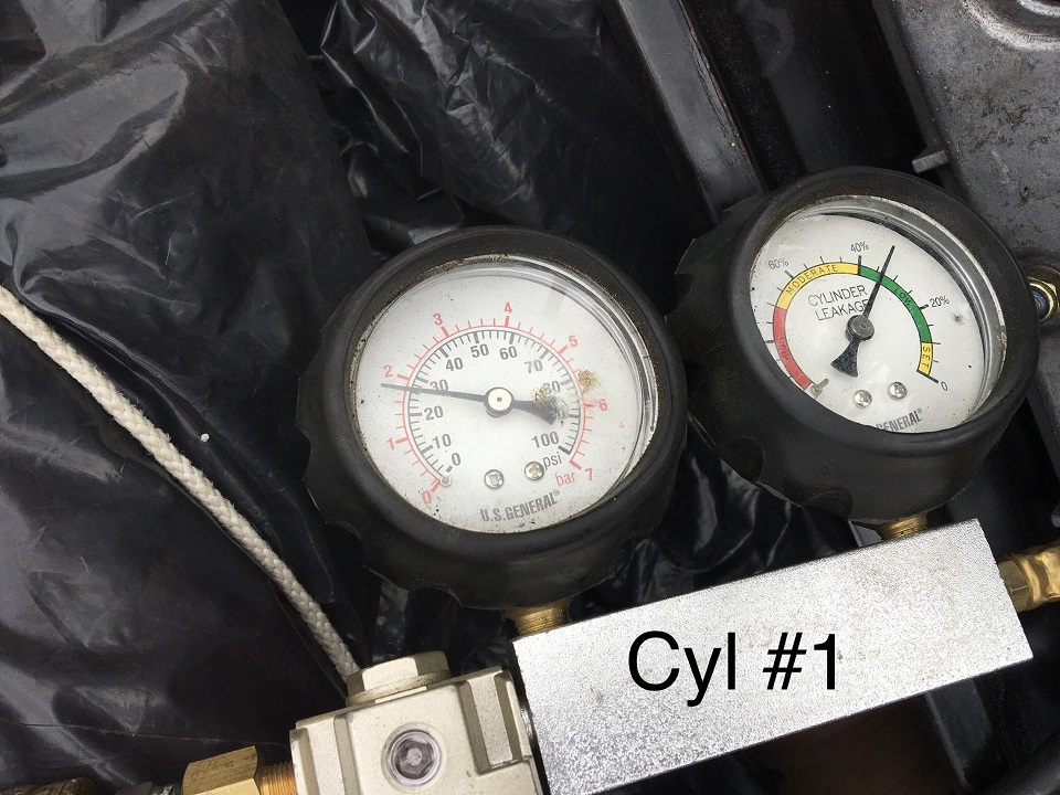

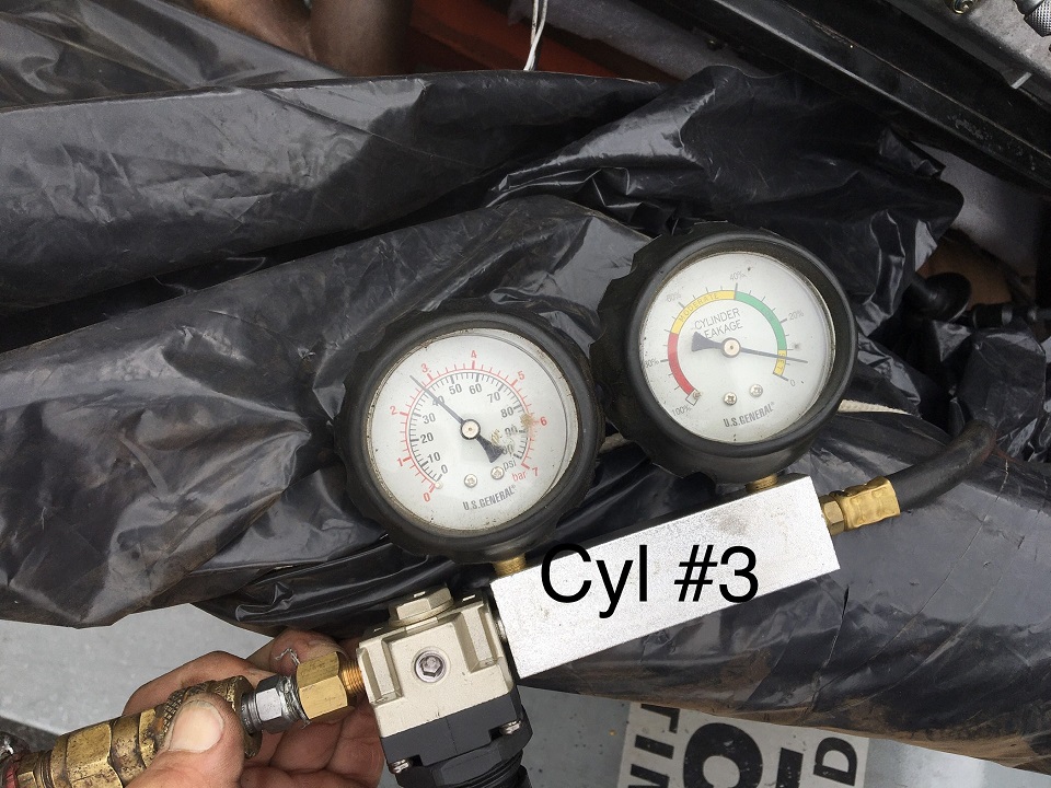

Here are the leakdown test results. This engine hasn't been ran for many years. Some good some ok values. Hopefully some of the OK values are due to it not having ran in a while. (IMG:style_emoticons/default/confused24.gif)
And plugs looked all like this:
