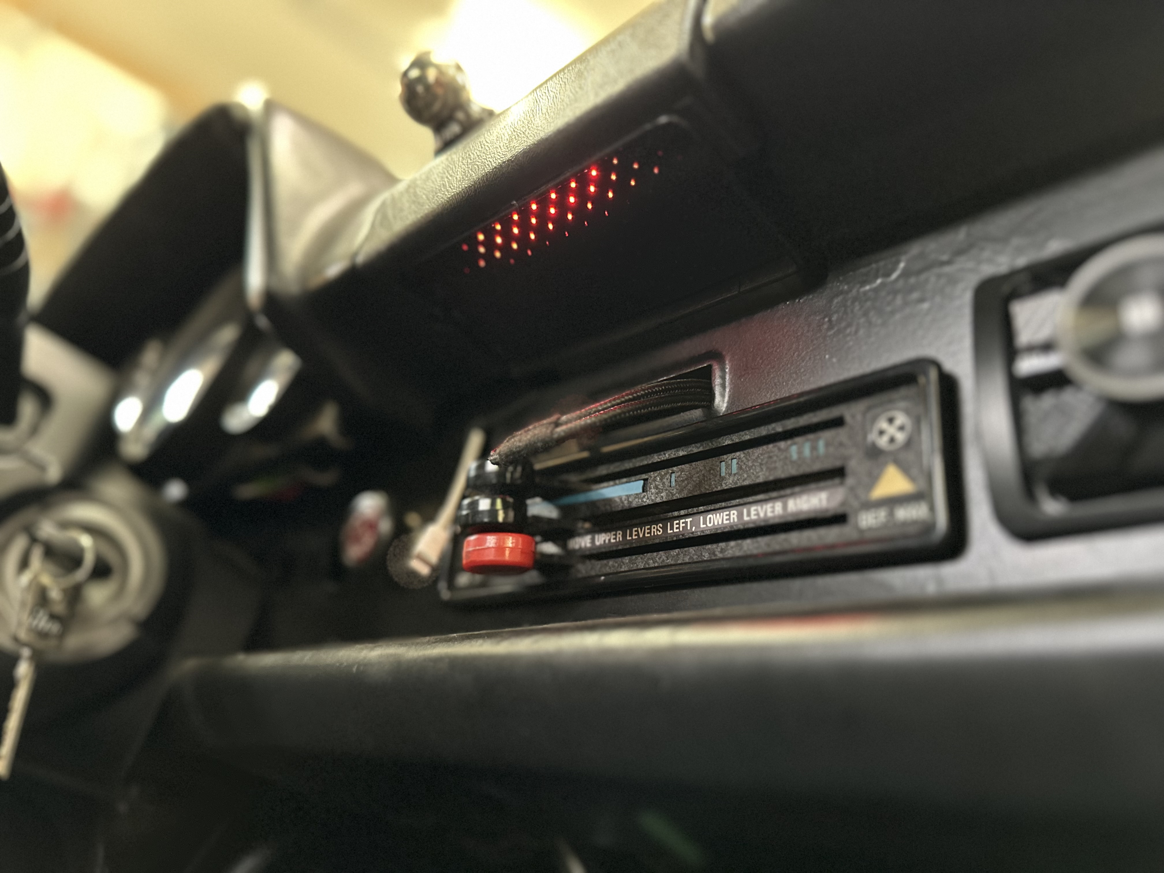

Had some recent inspiration while cleaning the garage and following these earlier sunsets.. console area lighting.
Rare when all project materials are within line of sight and it actually gets completed in one sitting.
