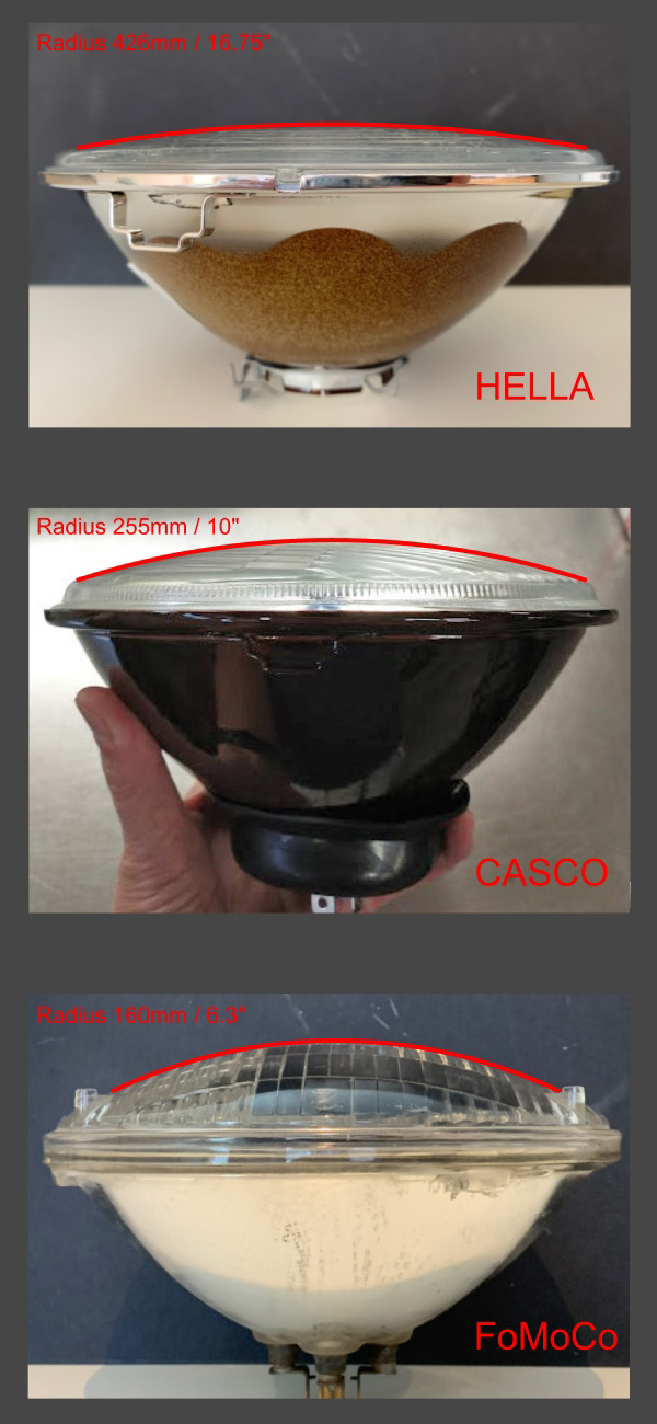

Just beware of two things: beam distribution/quality (how the fluting actually works) and front glass curvature (appearance).
When I was doing the H4 conversion for the 7" lamps on my '57 T-Bird, I first bought a pair of Hella's. Great light distribution, but the front face is nearly flat. In a car like the T-Bird, where the "eyes" are the most prominent feature of the front, they looked awful. The original sealed beams from Ford were almost spherical.
Finally I went with an intermediate H4 conversion kit offered by my T-Bird supplier, not as round-y as the originals, but not as flat as the Hella's. They look good on the car, but the light distribution is not nearly as good as the Hella's. As I don't drive this car much at night anyway, it doesn't really matter. The 914 I have now came with the Hella's already, the fact that they are flattish doesn't stand out nearly as much in this case, and of course they spend most of their time folded in.
