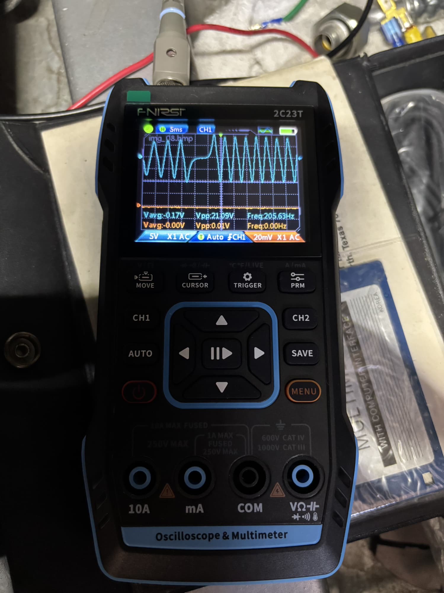

Muffler hanger fixed and I am now getting full throttle. Motor turns over but still doesn’t start. DME relay and speed sensor test out fine. Bought a DVM oscilloscope from Amazon to troubleshoot the speed sensor. I love toys! I also bought a Durametric OBD1 reader. The OBD1 reader shows up tomorrow.
Here is a picture of the speed sensor sine wave on my dvm oscilloscope.
