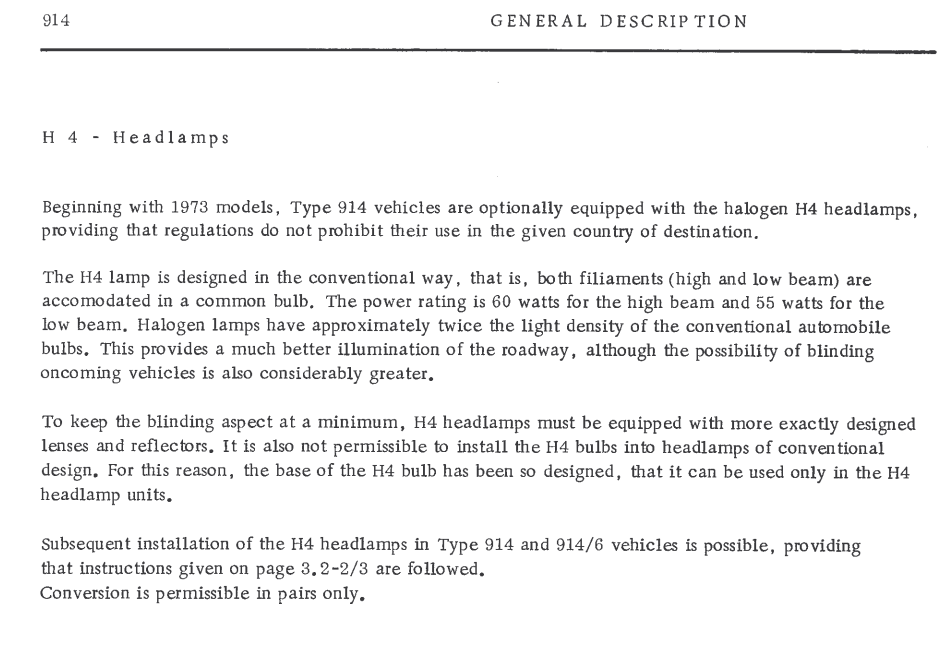

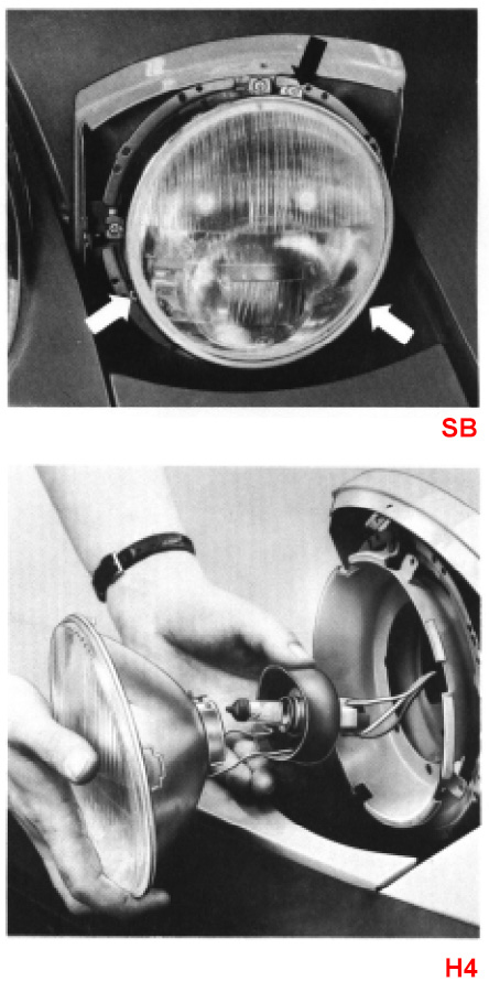

Not sure why you would need additional relays - at least in '73 or later models. The H4's draw the same 55/60w as do standard sealed beams. From the manual:
The image of the H4 from the manual already looks flatter than the sealed beam.
Of course, the H4's were never factory-installed on the 914's sent to the US - non sealed beam units were only allowed in the US after 1983.
