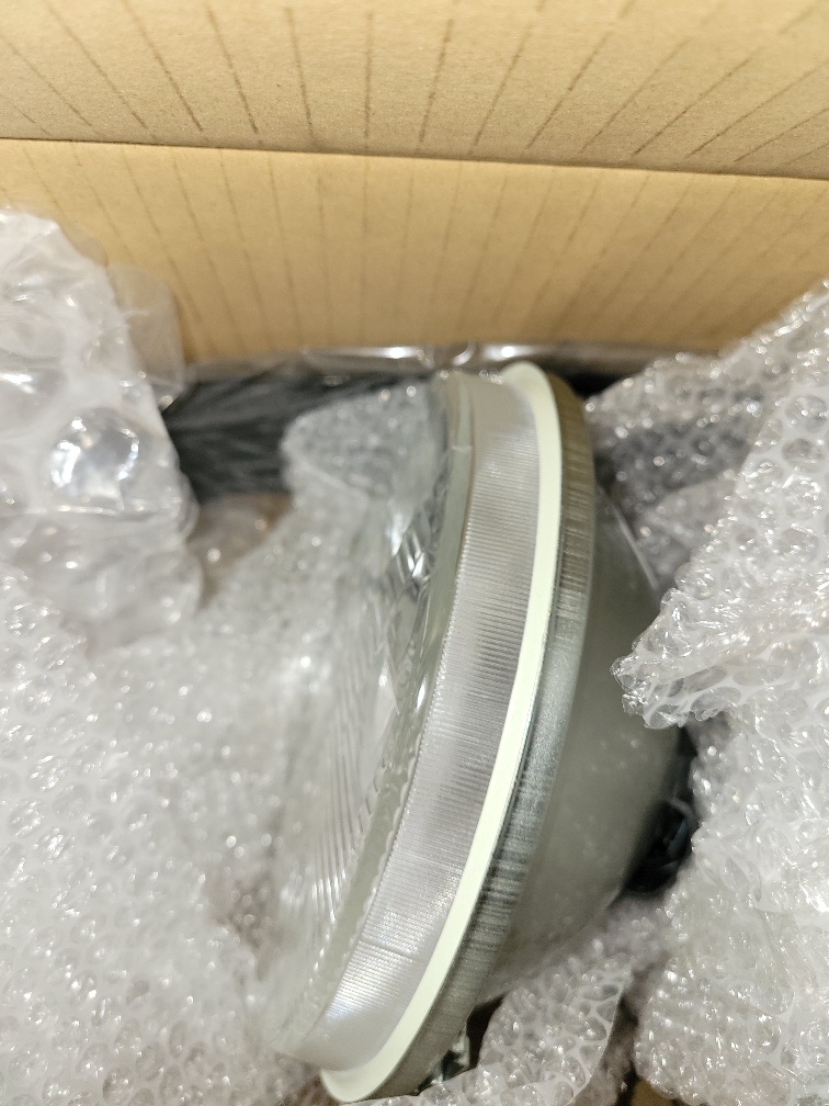

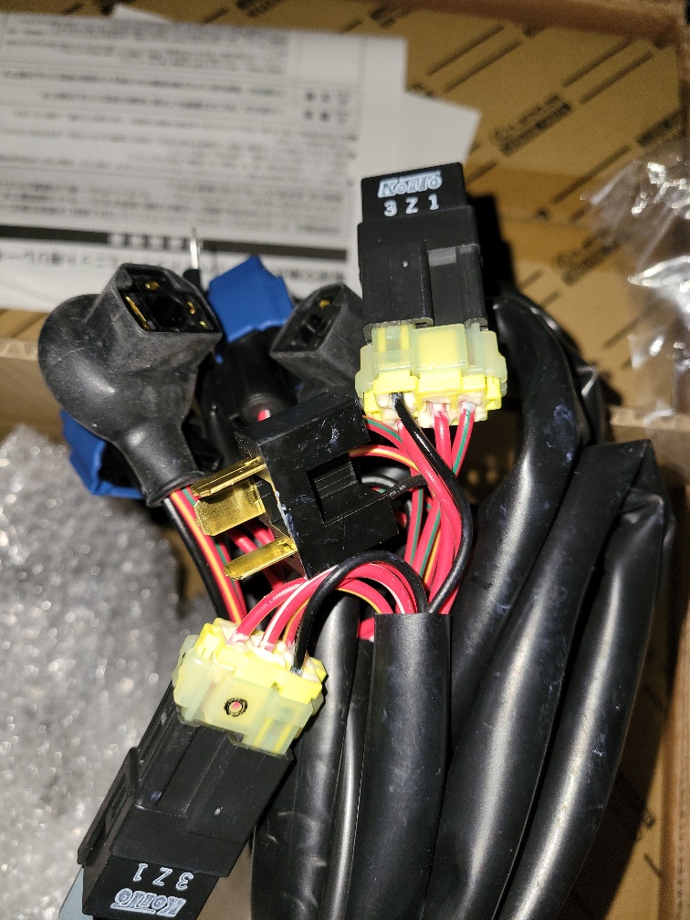

Half the reason for buying E Codes back in the day before LEDs was to run higher wattage H4s without blinding oncoming traffic. My go to's were 80/100W. Definitely needed relays for each bulb. Can't speak to my 914 but my 87 911 runs headlight power right through the headlight switch, which I had to replace because years of high watts through it melted the plastic internals.
The Toyota comes with 4 relays, rubber boots on the headlight side of the harness and dielectric grease in every wire end. Quite the deal.
(IMG:http://www.914world.com/bbs2/uploads_offsite/i.imgur.com-14731-1727827567.1.jpg)
