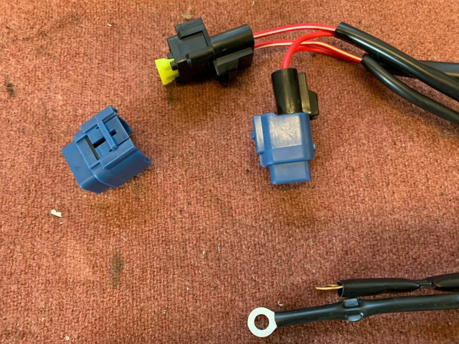

I'm surprised Toyota still sells something this old. At this price point (especially with employee pricing the cost drops) I may have to order a few for my 74 914 even though I already have the Hella H4 E-code housings installed. I've seen Koito bulbs last many years before kicking the bucket in my current run working as a technician in a Toyota dealership. The glass lens does seem to protrude outwards more than the Hella E-codes lenses which are for the most part flat. @technicalninja The blue covers in the harness are covering inline fuses. I found a picture of the harness from a eBay seller.

technicalninja   Covered fuses! There's two of them and tw...   Oct 3 2024, 08:19 AM
