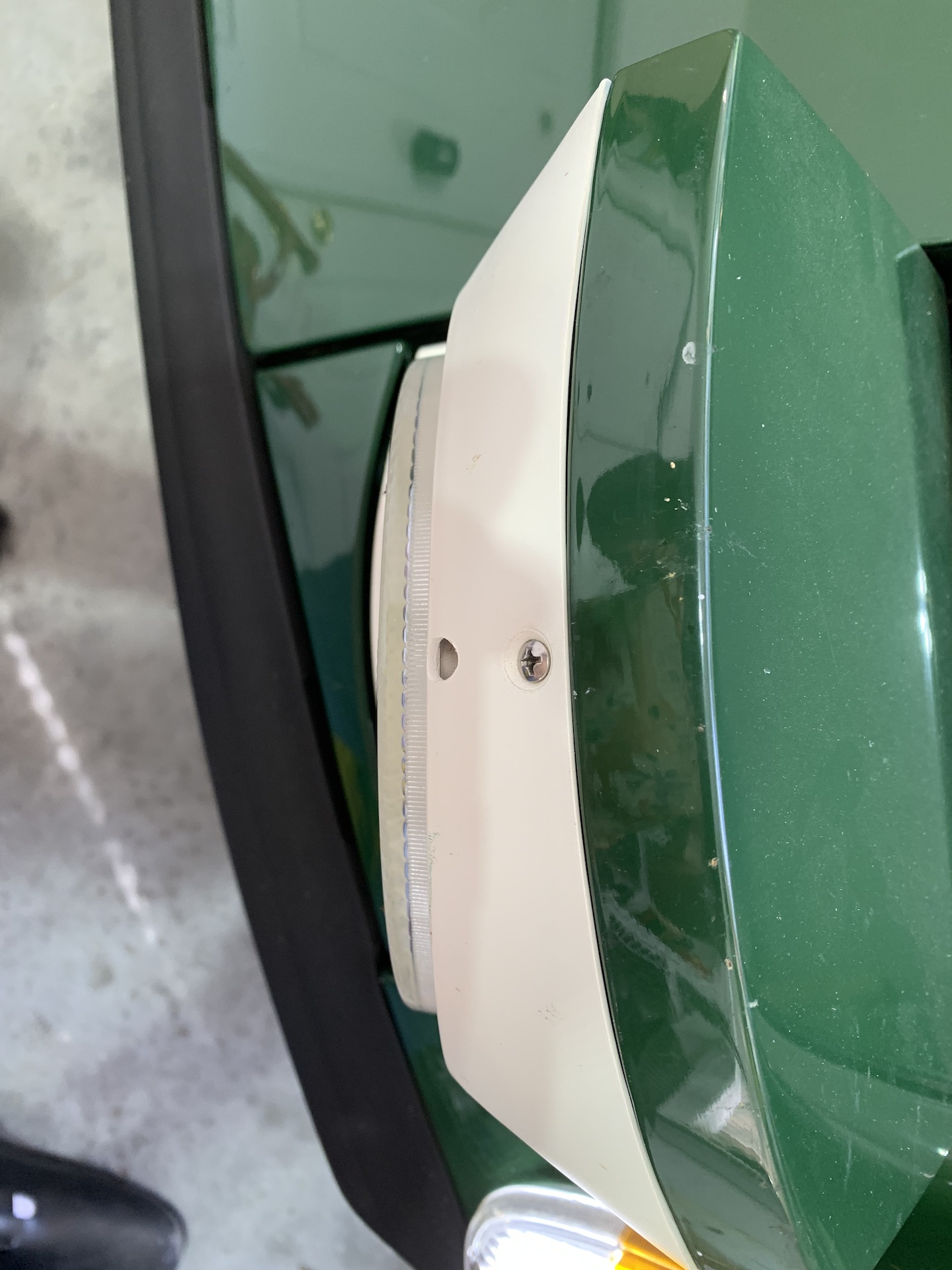

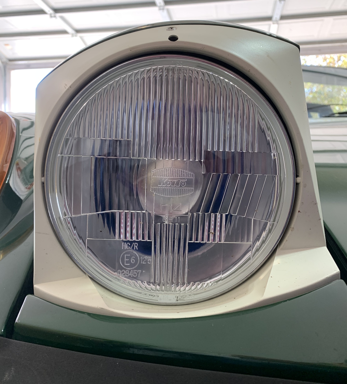

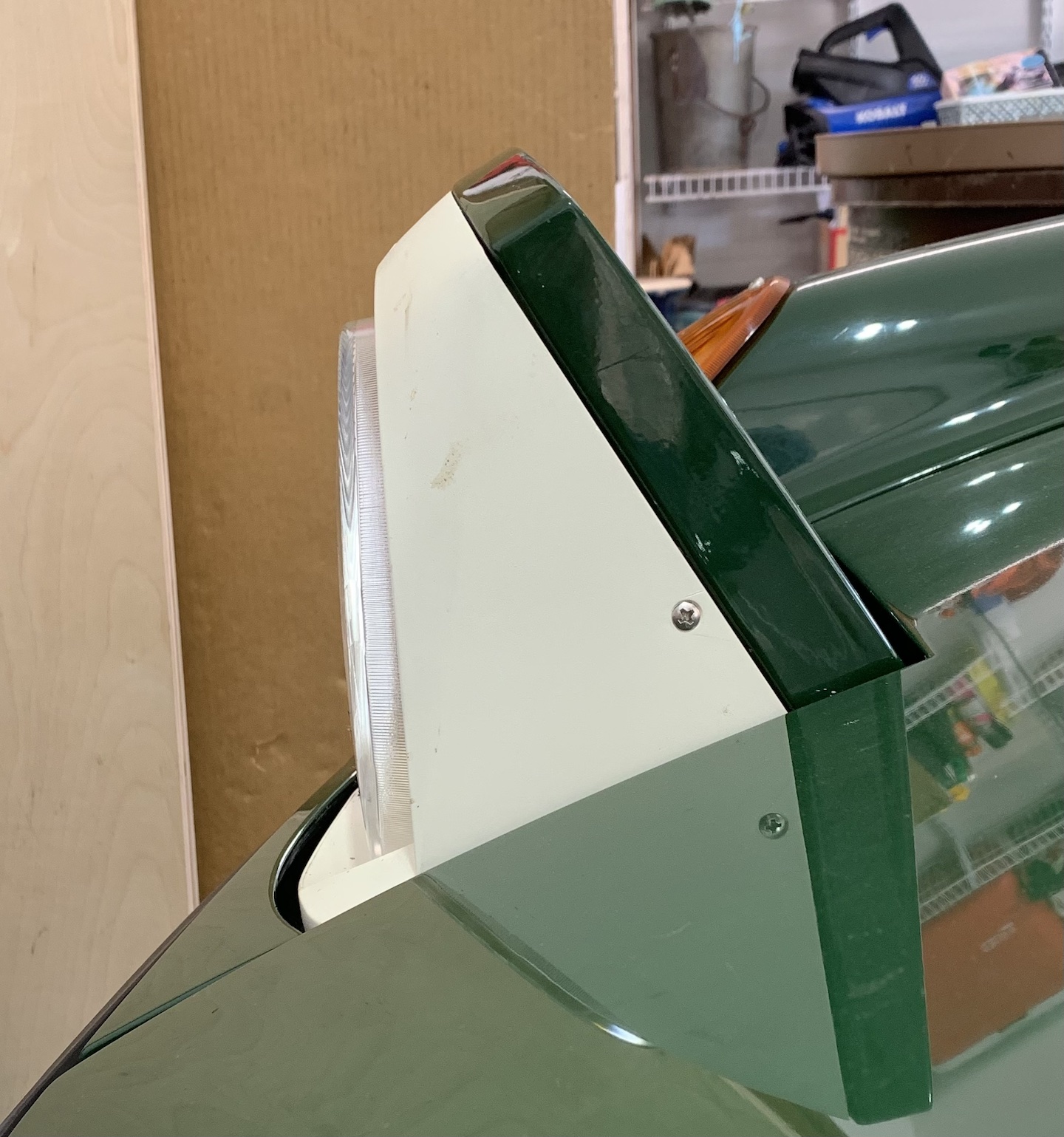

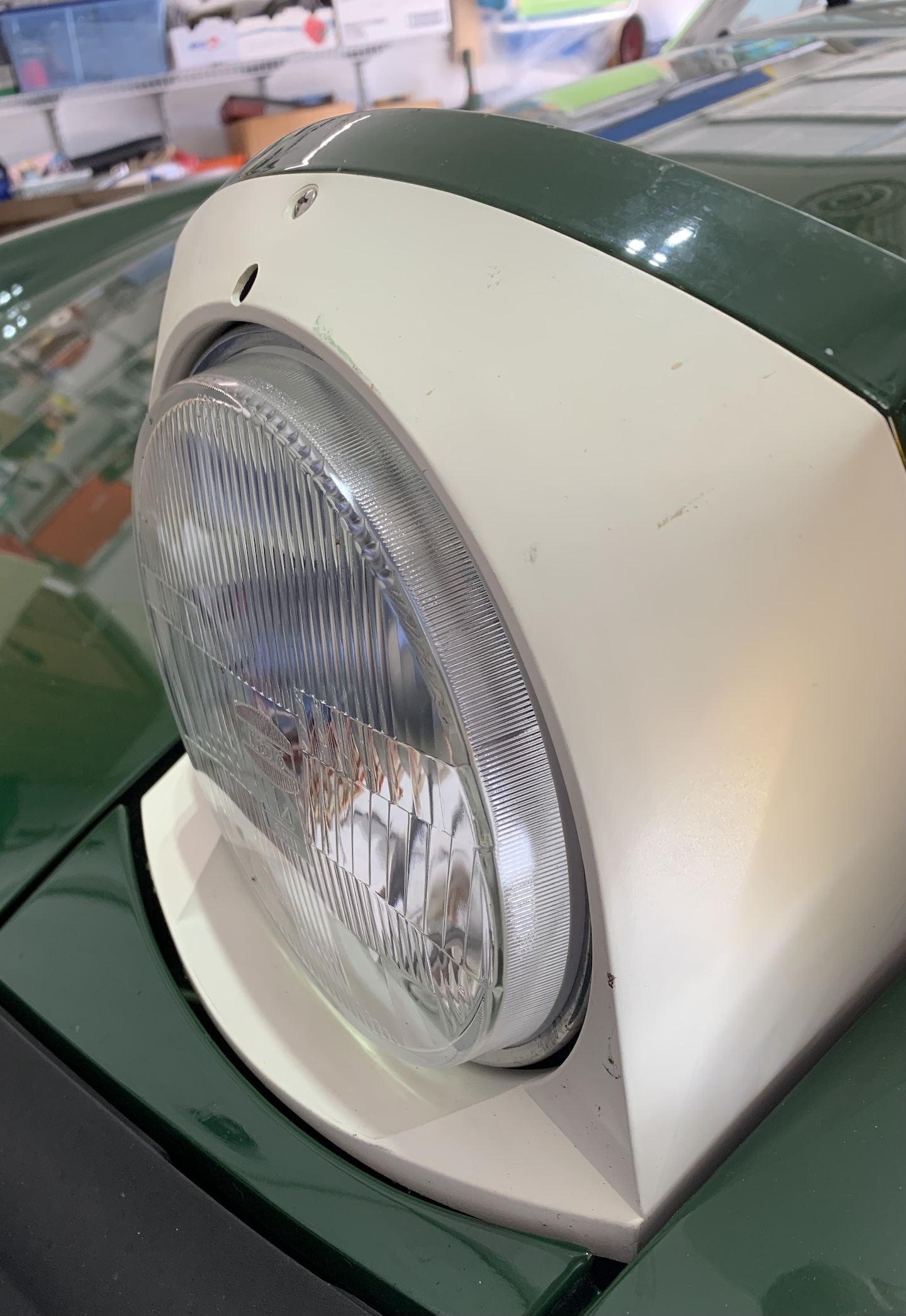

I picked up one of these kits last spring. I'm using the new Koito headlights in the 914 in place of the SEV Marchal "flat face" lights I had been running. Here are a few pics showing how they look in the car:
There's no physical interference (at least on my car), and the lighting performance is almost as good as my old Marchal lights (and I wouldn't care as much if one of the Koito lights took a rock).
FWIW, the Toyota harness will go into my old Volvo 240 (didn't need it for the 914 as I updated its wiring using the 911 relay kit from JWest Engineering).
Hope this helps!
