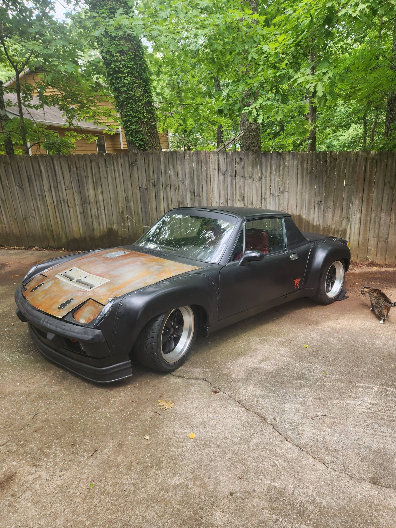

Finally got the car moving... Took it off to tuning.. 325 at rear wheels..
Now going through and fixing all the ugh ohs that I find from 18 years of building and various levels of skills. On my third pressure switch for brake lights!!! finally figured out how to test before new one goes in.
Bunch of little electrical issues.. I pulled a bunch of the looming re-doing things. Of course with the hand looming is a time consuming process!
Also nut and bolting make sure everything is tight and out of the way. Had to replace the boxster tranny, issues going into reverse. We are going to see what we might be able to do to fix????
Now thats it on the ground after all these years I need a hard hat!! I keep running my head into the open hood!!
Got to take it around the block a few times!! lots of fun.

d914   Finally got the car moving... Took it off to tunin...   Oct 23 2024, 09:59 AM
Shivers   Sits really nice. Congratulations   Oct 20 2026, 03:34 AM
Root_Werks   That has a serious outlaw look, nice!   Oct 23 2024, 10:31 AM
930cabman   That has a serious outlaw look, nice! :ag...   Nov 17 2024, 05:29 PM
d914   thanks. started a little down that road and just k...   Oct 23 2024, 10:37 AM
slowrodent   Very impressive end result.... Rather menacing loo...   Oct 23 2024, 11:07 AM
flyer86d   It’s simple. I love it!   Oct 23 2024, 03:04 PM
