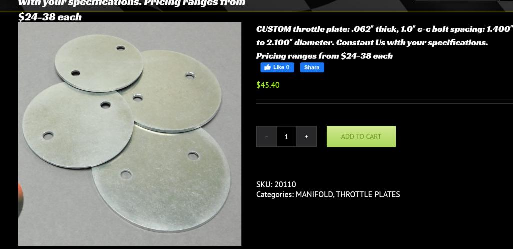

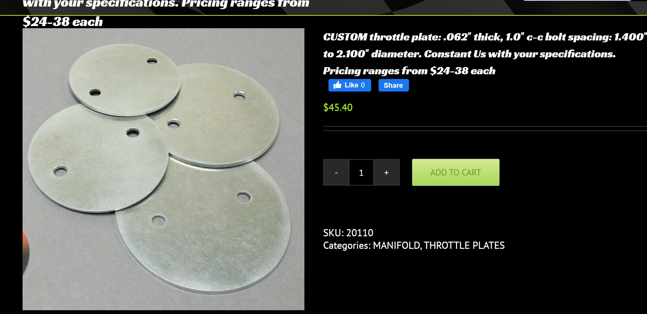

flxzcat
post Nov 6 2024, 04:18 PM
Posts: 137
Joined: 13-June 11
From: Lake Forest, So. Cal.
Member No.: 13,188
QUOTE(mepstein @ Apr 9 2024, 03:35 PM) *
There are places to send a throttle body out, get it bored and a larger butterfly made. $150-250 usually. Just Google it. There’s more than one place to get it done.
Kinsler Fuel Injection
https://kinsler.com/Shop/product-category/m...hrottle-plates/
will make or has custom throttle plates. They offer other thicknesses. Probably will bore the body as well. You will have to contact about boring as its not on their website
