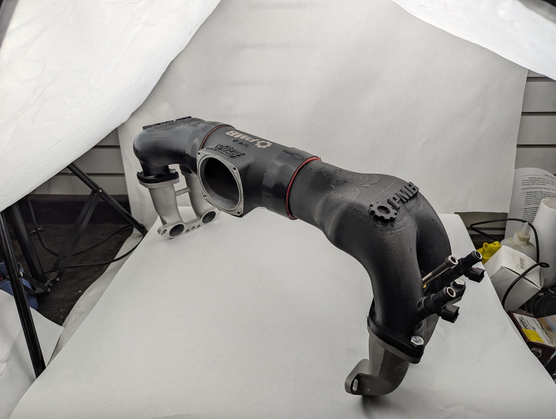

I watched this video from Jake Raby over the weekend. It's always interesting listening to him talk about R&D. It seems that he and Mario from the Dub Shop have been working on their own version of a more modern Single Throttle Body EFI. Hopefully, those interested can access this link:
https://www.facebook.com/aircooledtech/vide...925350345685623
JamesM
post Nov 8 2024, 01:44 AM
Posts: 2,337
Joined: 6-April 06
From: Kearns, UT
Member No.: 5,834
QUOTE(Craigers17 @ Nov 7 2024, 02:55 PM) *
They aren't the only ones (IMG:style_emoticons/default/biggrin.gif)
Back in the day when Jake still despised Megasquirt he reached out to me and we spoke a bit on the subject. Despite bad experiences he has always been forward thinking enough to realize aftermarket injection was the way forward. Unfortunately at the time my day job prohibited me from being more involved assisting in his path. Glad to see him working with Mario though as he has delivered some awesome products for injecting our engines. Most people that spend any time playing with this stuff though quickly realize the shortcomings of ITBs so I'm really glad to see the two of them jumping on this problem.
That said, single plenum intake manifold design is a pretty complicated subject. While I don't actually know what all they have put into the project so far it appears their approach is based on improving a type 1 style injection manifold with a hyper focus on improving flow and while I am sure this will absolutely remove restrictions over the stock type 1 setup efficient plenum design involves more than just maximizing flow. Runner and plenum lengths, volume, shape, and orientation all have impact on the end result. Theory is one thing though and dyno results are another so as someone who has been playing with modern injection on 914s for the last 20 years I couldn't be more excited to see the results.
Now back to my original comment...
For a while before "officially" starting work for PMB I had been advising Eric on fuel injection matters and the ITB/single plenum problem has been something I have brought up quite often. After throwing a few ideas on the table Eric picked up the ball and got some prototype bits fabbed up. Our approach was a little different in that rather than trying to improve an old design we went with adapting a more modern one.
Been put on the back burner for a bit as I have had other work to address, but anyone that attended the last open house may have noticed a a slightly more complete version of this bolted on a motor:
