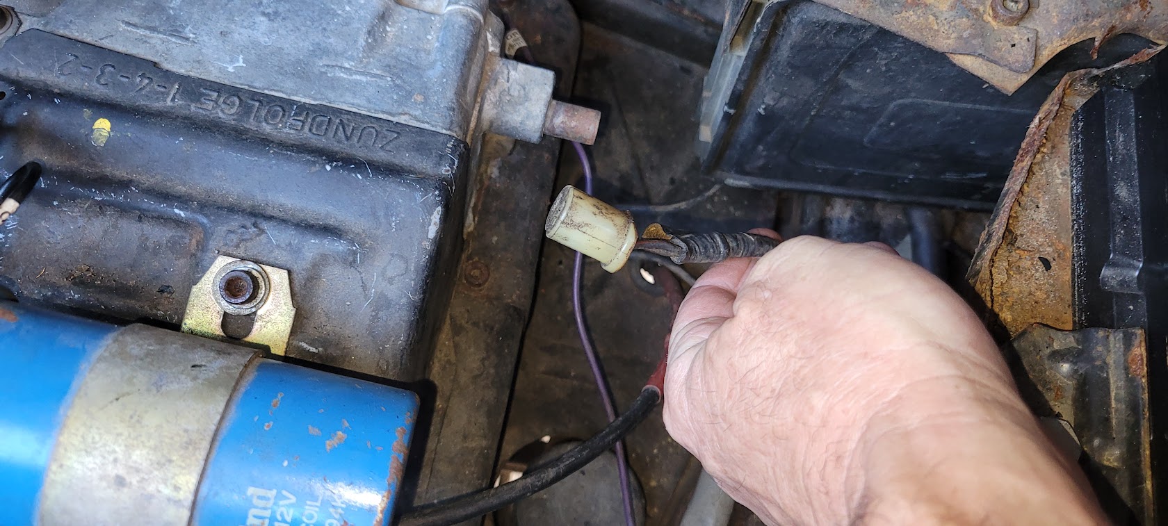

I pretty much give up today I attached the green wire and it did seem to start for a sec and I shut her down..to make sure everything was looking good..
now nothing again.. the zip ties on the wires are just that 3 zip ties on cylin 3 4 on the 4 wire 2 on the two wire..the way I got it..
Can't win..
more pics I guess I suspect its a 1.7 but I thought it was a 1.8 as to many parts I've ordered..
Thought I saw a video on the yellow fuel injectors being 1.7 only..I don't know what I have..funny thing is it wasn't running too bad...until I messed with it now nothing..geezeAttached Image Attached ImageAttached Image

sportlicherFahrer   Noticed something in one of your previous photos t...   Dec 6 2024, 09:29 AM
thecleanoutking   sportlicherFahrer...Dude...your the friggin man......   Dec 6 2024, 03:39 PM

thecleanoutking   wow!!..Great eye..Thanks so much guys and ...   Dec 6 2024, 10:19 AM
