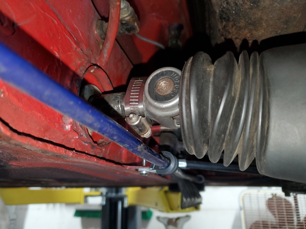

Every 6 months I have to retighten the cone screw on the shifter. This time it came out real quick. I thought it might come out all together. I couldn't get 2nd without hitting reverse. The picture shows how much the screw backed out.
Not sure how much torque I applied but I was bending the allen wrench.
Questions:
Should I have thread locker on this?
What is the torque required for the cone screw?
Possible that the threads have been widened by repeated looseness?
Why didn't they put a bolt through this to really lock the hub onto the shaft?
TIA

Problem solved. Sort of. At least I can move the car around before making a permanent repair.

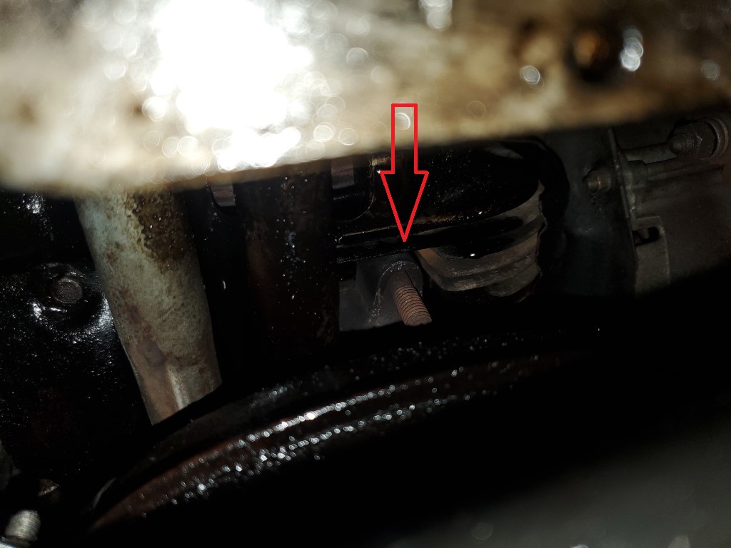

While inspecting under the engine, I noticed one of the exhaust bolts is missing.

brant   Intended to be one time use Replace both. And you...   Dec 6 2024, 07:33 AM
JamesM   Intended to be one time use Replace both. And yo...   Dec 7 2024, 07:40 PM
Spoke   The cone screw thread appears to be folded over at...   Dec 6 2024, 08:03 AM
Superhawk996   The cone screw thread appears to be folded over a...   Dec 6 2024, 08:33 AM
87m491   The cone screw thread appears to be folded over a...   Dec 6 2024, 09:25 AM
Superhawk996   Why didn't they put a bolt through this to r...   Dec 6 2024, 08:29 AM
Steve   Unless their worn or partially stripped, I just pu...   Dec 6 2024, 08:55 AM
VaccaRabite   A small amount of blue loctite is all you need. T...   Dec 6 2024, 09:02 AM
Superhawk996   A small amount of blue loctite is all you need. ...   Dec 6 2024, 09:22 AM
930cabman   A small amount of blue loctite is all you need. ...   Dec 6 2024, 10:50 AM
ejm   First time I've seen a cone screw facing up. I...   Dec 6 2024, 11:14 AM
930cabman   First time I've seen a cone screw facing up. ...   Dec 6 2024, 12:52 PM
r_towle   First time I've seen a cone screw facing up. ...   Dec 9 2024, 07:30 PM
Spoke   First time I've seen a cone screw facing up....   Dec 9 2024, 07:47 PM
rjames   I don't know what the exact spec is, but it...   Dec 6 2024, 11:44 AM
GregAmy   I know it's often said these are one-use items...   Dec 6 2024, 11:49 AM
Spoke   I cleaned up the first thread on the cone nut and ...   Dec 6 2024, 12:26 PM
flipb   If you want to replace the coupler, the part numbe...   Dec 6 2024, 03:26 PM
mb911   Every 6 months I have to retighten the cone screw...   Dec 7 2024, 07:20 AM
DC_neun_vierzehn   This is the cheapest I've found the Genuine Po...   Dec 7 2024, 08:42 AM
Bartlett 914   I reuse mine. I use a torch and warm the screw. Yo...   Dec 7 2024, 08:43 AM
930cabman   I reuse mine. I use a torch and warm the screw. Y...   Dec 7 2024, 09:39 AM
Bartlett 914   I reuse mine. I use a torch and warm the screw. ...   Dec 7 2024, 01:30 PM
brant   I've salvaged knuckles in the past... take the...   Dec 7 2024, 08:43 AM
rhodyguy   That’s why you buy 4 at a time. They fit in the ...   Dec 7 2024, 02:14 PM
sixnotfour   I wish they still had the square head with lock wi...   Dec 7 2024, 06:24 PM
SKL1   Thanks for the part numbers! Think I'll o...   Dec 7 2024, 09:13 PM
913B   I remember there was a vendor that had a modified ...   Dec 8 2024, 12:45 PM
Spoke   Problem solved. Sort of. At least I can move the c...   Dec 9 2024, 10:11 PM
930cabman   Problem solved. Sort of. At least I can move the ...   Dec 10 2024, 11:18 AM
Spoke   Side note, how is progress with your 930? The t...   Dec 10 2024, 03:07 PM
TheCabinetmaker   Your coupler is on upside down. Get a new coupler ...   Dec 10 2024, 10:35 AM
930cabman   Your coupler is on upside down. Get a new coupler...   Dec 10 2024, 11:17 AM
