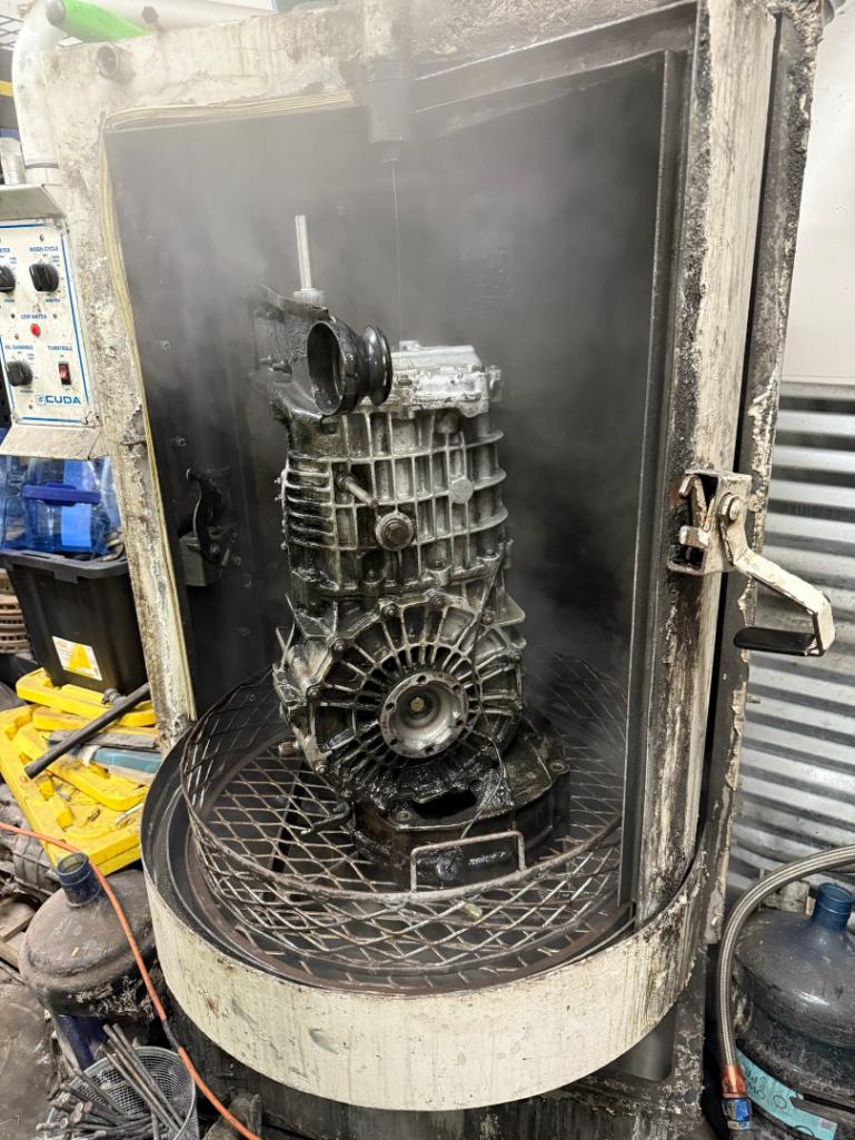

The transmission is being worked on now. Here it's getting a cleaning.
Going to clean up the harness and send to Dennis (Timmy2) to have a new harness made.

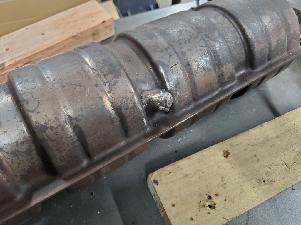

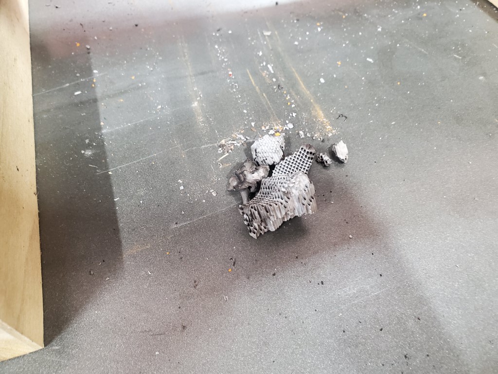

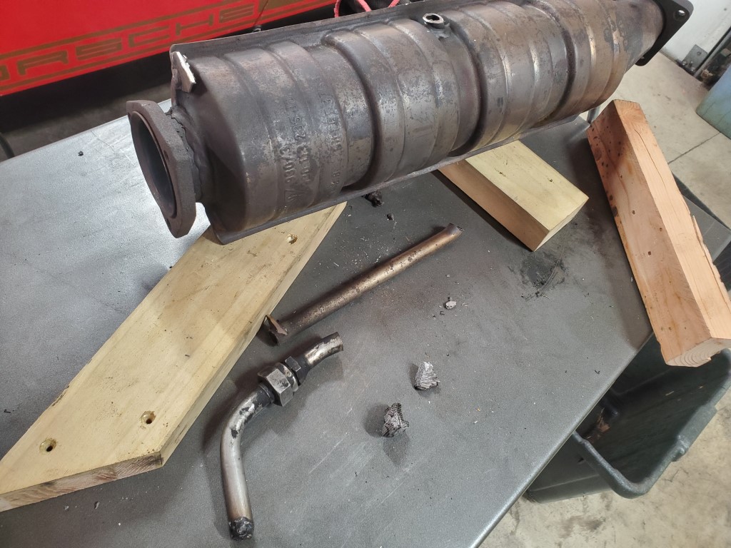

Removing the air injection port to the cat for the emissions system. The pump and valves are long gone.
The internals of the cat have partially melted. Found several molten chunks in the muffler as well.
Port welded up.
