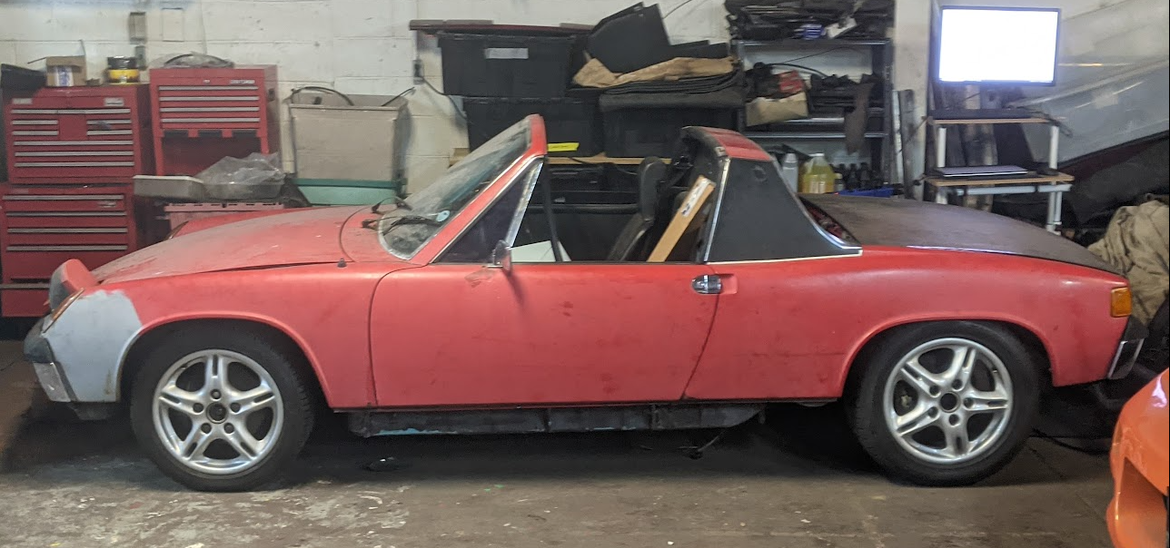

Road Roach with Boxster Wheels 16x6 front 16x7 rear. 205/55. 7 in wheels ET 40. Paid $400 with brand new Falkens. Attached Image
