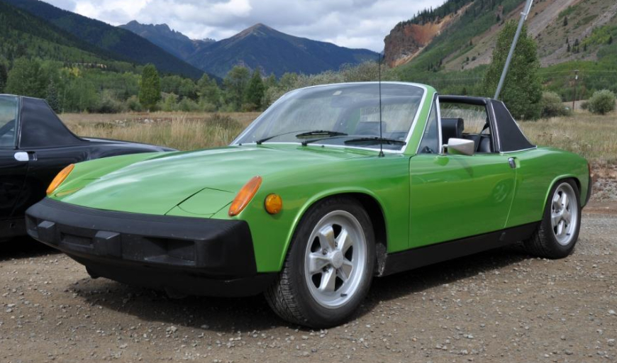

I'm piss poor at the search function on this site and was trying to find fitment info on this set up.
https://fuchswheelcompany.ca/product/16x7-f...eel-for-porshe/
They list it a 16X7 with an offset of 23.3.
From what I have found so far, they look like they might require 12 mm spacers to work on a stock 75 914 narrow body.
This car will be at or near stock ride height and a weekend play toy. It currently has no sway bars but that will probably change...
I'm planning on using PBR's 5 lug 914-4 front rotors, the Uro 914 5 lug rear flange with turned down PBR 914-6 rear rotors, and stock calipers.
I'd like to use this tire. (205/60r16)
https://www.tirerack.com/tires/TireSearchRe...performance=ALL
I'm new to the 914 and can't figure offsets properly yet on this chassis
I would appreciate thoughts, tips and any suggestions.
Do I have a chance?

I've just welded an inch to the inners ,,911R offset,,, My76 I made 16x7.5s,,special spacers required.. and I used inners cut from 16s being made into 2 piece 17s,, There is one weld seam..
