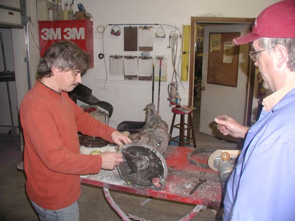

close up checking it out

spare time toys   Trans cutting photos   Feb 2 2005, 07:13 PM
spare time toys   getting ready   Feb 2 2005, 07:14 PM
spare time toys   the cut begins   Feb 2 2005, 07:15 PM
spare time toys   success   Feb 2 2005, 07:15 PM
spare time toys   close up checking it out   Feb 2 2005, 07:16 PM
spare time toys   Chating with new pal John about his rods.   Feb 2 2005, 07:17 PM
