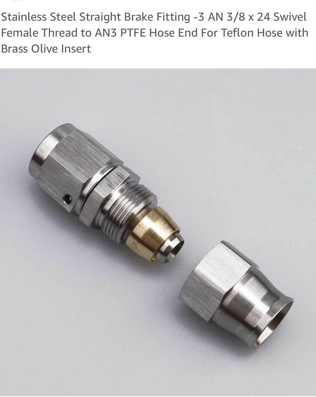

QUOTE(gereed75 @ Jan 4 2025, 02:44 PM) *
Hawk, I get your perspective but I don’t see any reason that the possibility of being in “a bad accident involving brake issues” goes up with a -3AN system. From an engineering perspective it should go down. The AN system has substantially fewer connections than the stock system - like four as opposed to maybe a dozen. Seems better to me.
Any recent examples of this technology being used in OEM applications?
Are we talking the same AN fittings as shown below?
No OEM is ever going to AN fittings. Cost is one thing. The multitude of failure points within the fittings is another. As far as I’m aware there are no DOT approved AN fittings. No OEM is going to use Non DOT parts.
Now I get the argument that AN derives from mil-spec parts. Despite what marketing may say, are you getting Mil-spec parts in retail? Not likely.
I have also personally used AN extensively in racing. Again, that’s another story where equipment is constantly being maintained and inspected. In the rare event of a failure, all activity is on closed course with willing participants that have signed waivers acknowledging the danger of the activity. Completely different than street use.
