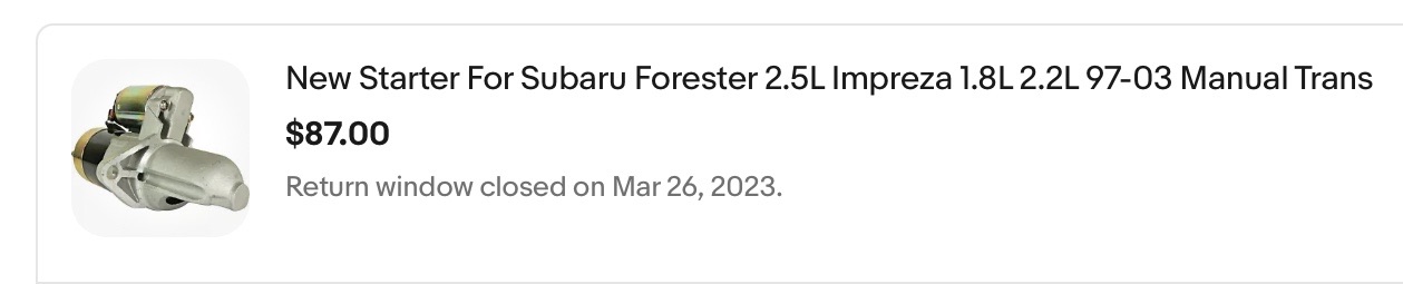

jamlip   Can anyone help me find a starter that will fit? ...   Jan 29 2025, 03:38 AM
East coaster   This is what I used and it worked/fit perfectly.   Jan 29 2025, 06:31 AM
jamlip   This is what I used and it worked/fit perfectly. ...   Jan 29 2025, 09:45 AM
76-914   Jamie, check Rock Auto. I bought the Denso reman w...   Jan 29 2025, 09:50 AM
jamlip   Thanks! I did - it was $20 more for a dif...   Jan 29 2025, 10:21 AM
