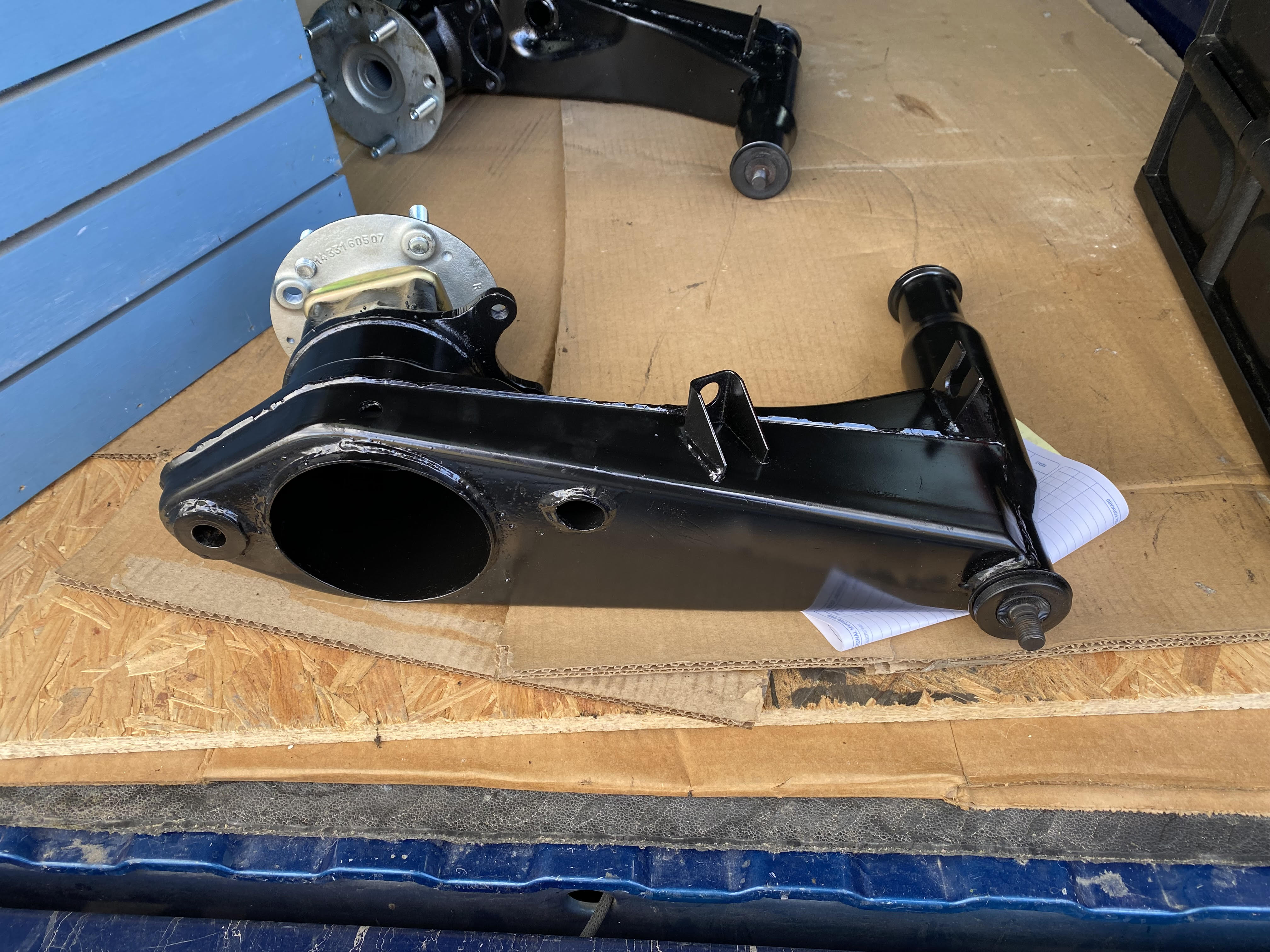

Chipping away and making some (slow) progress on the upgrades. I had Mark's German Auto handle pressing out the training arm bushings and the stuck stub axle (apparently that sucker was really in there). Got the arms back a few weeks ago and they look great with new paint and the 5-lug hubs installed.

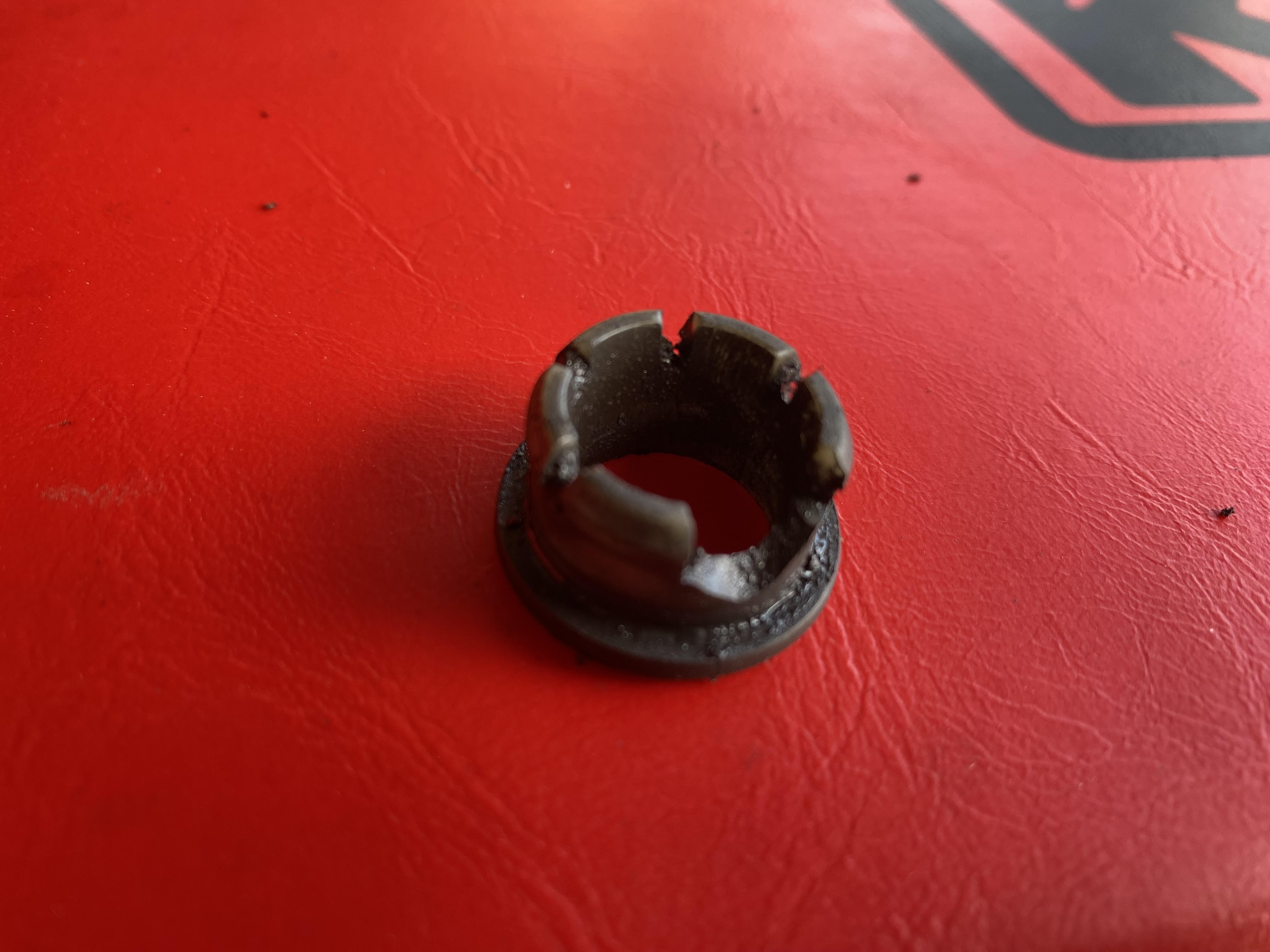

I was able to replace the trans output seals and noticed gear oil at the side shift console cover as well. Got the shift rod out and the seal replaced there as well. When I removed the shift rod at the firewall a small plastic bushing came loose at/near the coupler. I could use some help figuring out where this goes when re-assembling. It fits the OD on the rod at the firewall but is too large to the the ID of the coupler. Any help from the community on this is much appreciated!

Stratfink   Cleaned up the bushing - part number 914 424 224 0...   Mar 22 2025, 06:19 PM
bkrantz   Is that the bushing for the shift rod hole in the ...   Mar 22 2025, 07:38 PM
Stratfink   Is that the bushing for the shift rod hole in the...   Mar 22 2025, 09:23 PM

Stratfink   I have been thinking through the sequence of event...   Mar 29 2025, 04:54 PM
