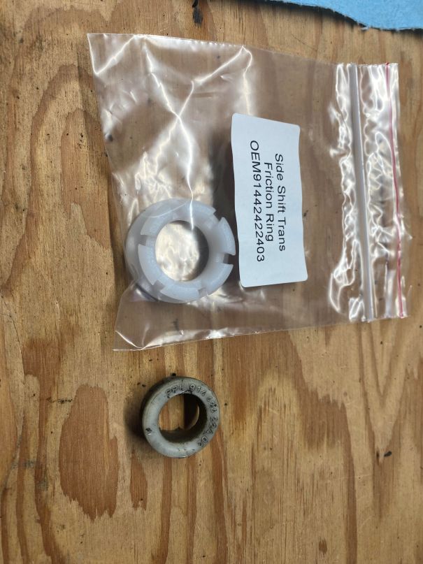

Is that the bushing for the shift rod hole in the firewall?

QUOTE(bkrantz @ Mar 22 2025, 06:38 PM) *
The part in question is considerably smaller than the firewall bushing (see comparison in the pic below). I am thinking it is the rear console bushing, just not sure why it would have been present if the brass bushing was installed by the PO. Planning to install the shift rod without that part tomorrow (IMG:style_emoticons/default/smile.gif)
porschetub
post Mar 24 2025, 04:15 PM
Posts: 4,886
Joined: 25-July 15
From: New Zealand
Member No.: 18,995
QUOTE(Stratfink @ Mar 23 2025, 04:23 PM) *
Pay to fit the washer on that console bush to the other side where the circlip is ,cheers
