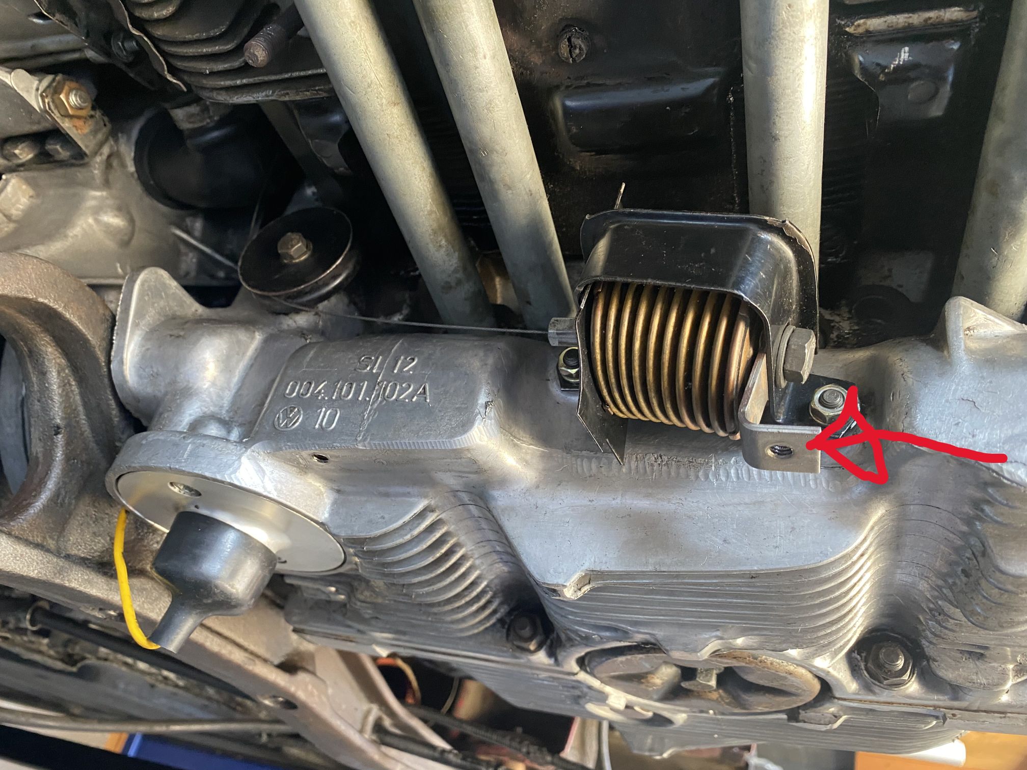

I temporarily installed the old thermostat last weekend (the new one arrived from awesome powdercoat yesterday. What is the additional L-Bracket that hangs off of the thermostat bracket and should it be oriented facing up or down as shown?

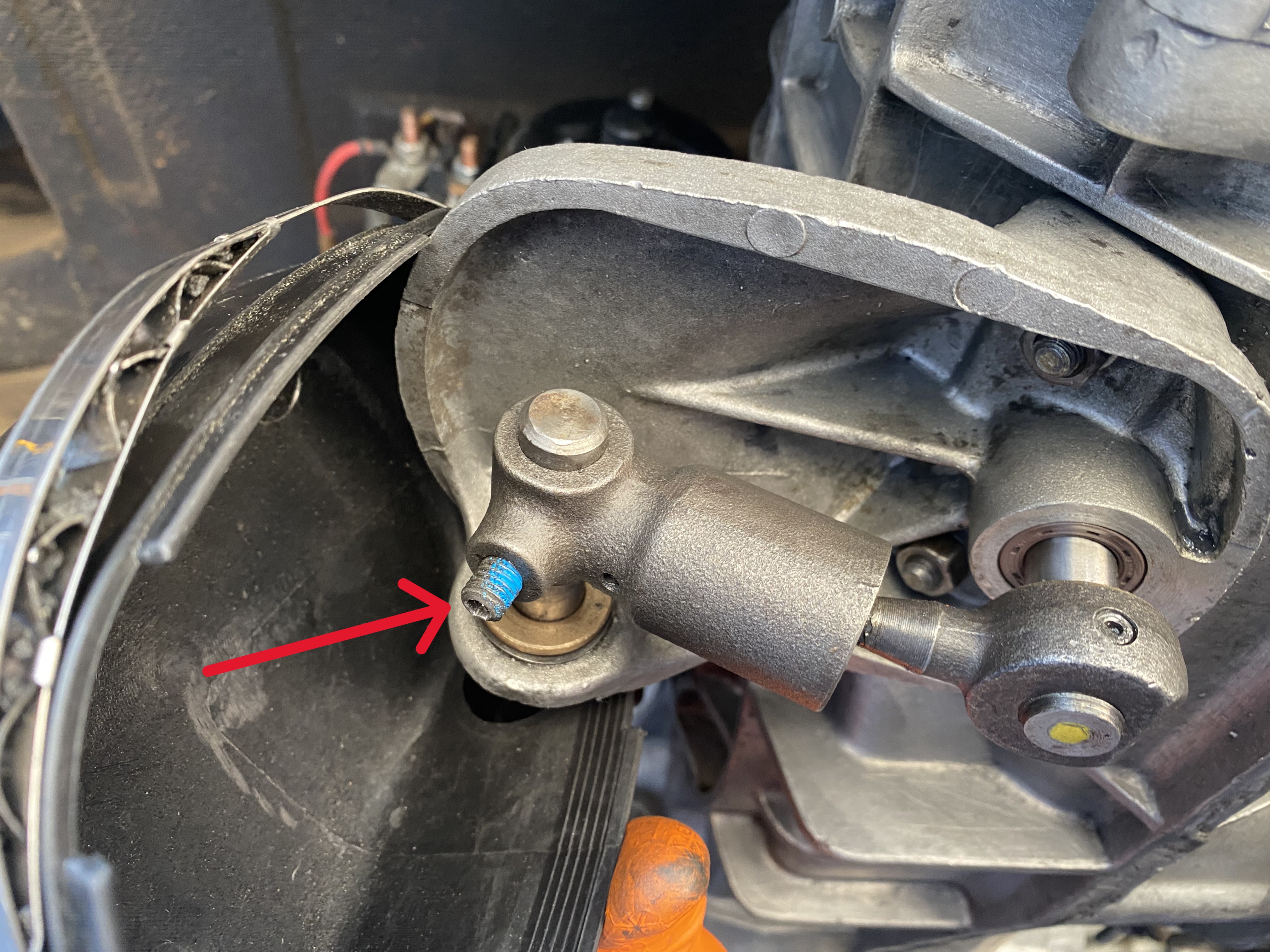

I expected the conical set screw to engage deeper into the shift coupler than it did. It seemed to be lined up appropriately but did not thread in that deep. Does this look correct?

Cairo94507   Great progress. That conical screw does not look ...   Apr 19 2025, 08:18 AM
JeffBowlsby   The L bracket is for the screw that holds the air ...   Apr 19 2025, 08:25 AM
Stratfink   Awesome - thanks for the replies Jeff and Cairo...   Apr 19 2025, 08:38 PM
Dave_Darling   I have had some success wiggling the coupler to ge...   Apr 19 2025, 08:55 PM
Stratfink   Thanks for all the inputs - shift rod is done (con...   Apr 26 2025, 09:09 PM
Dave_Darling   The rotor isn't firmly held in place until the...   Apr 27 2025, 05:45 AM
