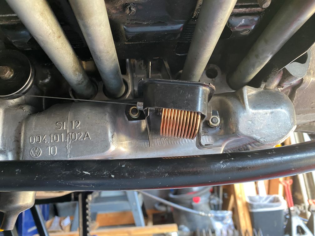

Generous amounts of PB Blaster were applied to the fasteners for several days before pulling this apart. Luckily no exhaust studs snapped - however in 3 locations the studs came out instead of the nuts coming loose.
You can see the condition of the threads in the picture. Also shown are the new nuts I purchased (although the copper lock nuts are the wrong thread size). I have not tried to remove the old nut from the stud now that the stud is out of the car - perhaps best to get new studs for these 3 locations. I also plan to use some anti-sieze for the re-install.
After getting the exhaust out I could see that there had been some oil leaks that should be addressed. More on that in the next post (as well as the start of the 5-lug work that I got into while stressing about the oil leaks...).

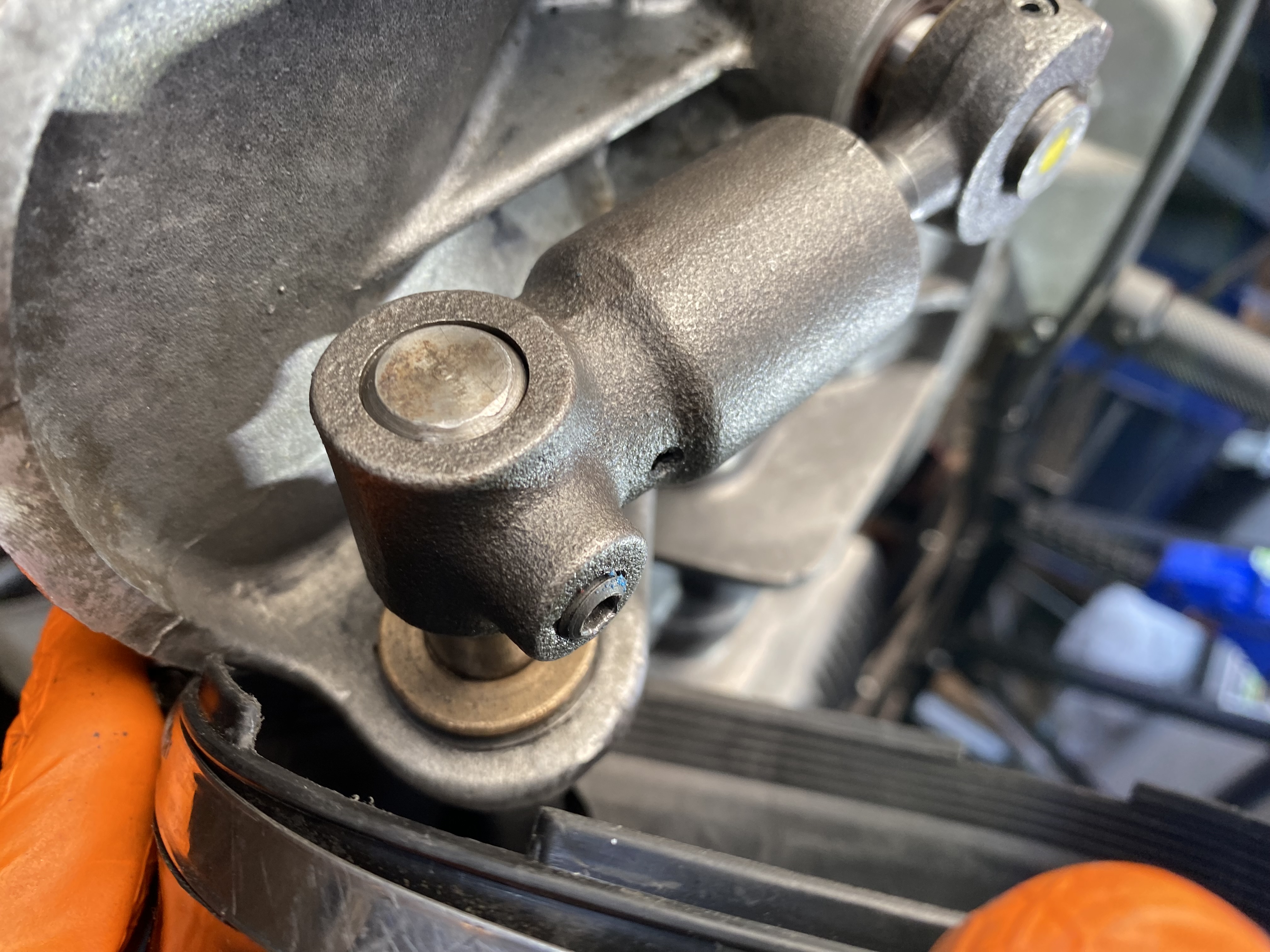

Thanks for all the inputs - shift rod is done (cone screw properly seated now) and new thermostat from Awesome Powdercoat got installed last weekend.

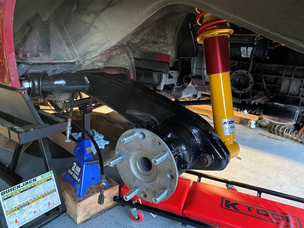

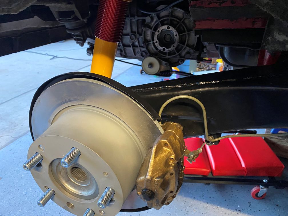

Some trial and error today in sequencing all the brake components (dust shield) but the passenger side is now in and looking good.
Started on the drivers side and got the trailing arm in and shock installed - but noticed a rough spot when rotating the hub. I am thinking that since these sat for a while on the garage floor maybe there just needs to be some run-in for this to smooth out. Anyone experienced this before? I'd like to make sure this will be OK before building up the brakes on this side.
Fully seated cone screw:

Drivers side:
