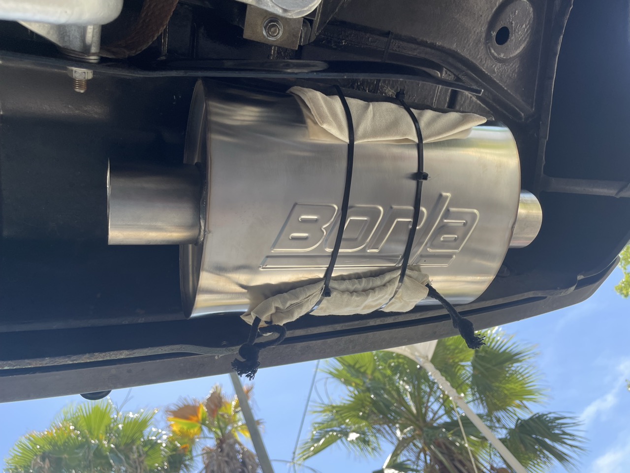

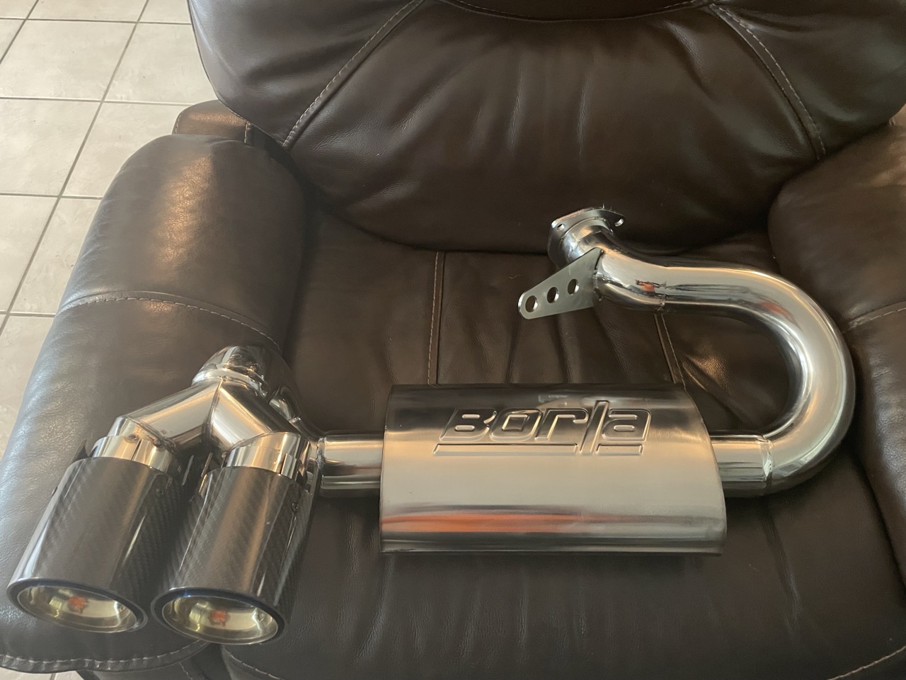

Pics of the exhaust…it being mated up to the MSDS header that I purchased. By the way…very good quality header made right here in the USA. And even better than that, the customer service is top notch! Had a few issues to work through and response was immediate (IMG:style_emoticons/default/biggrin.gif)

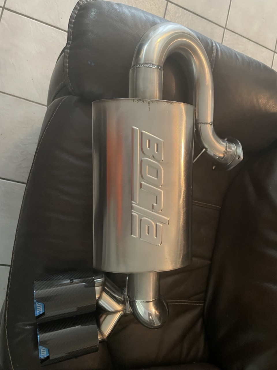

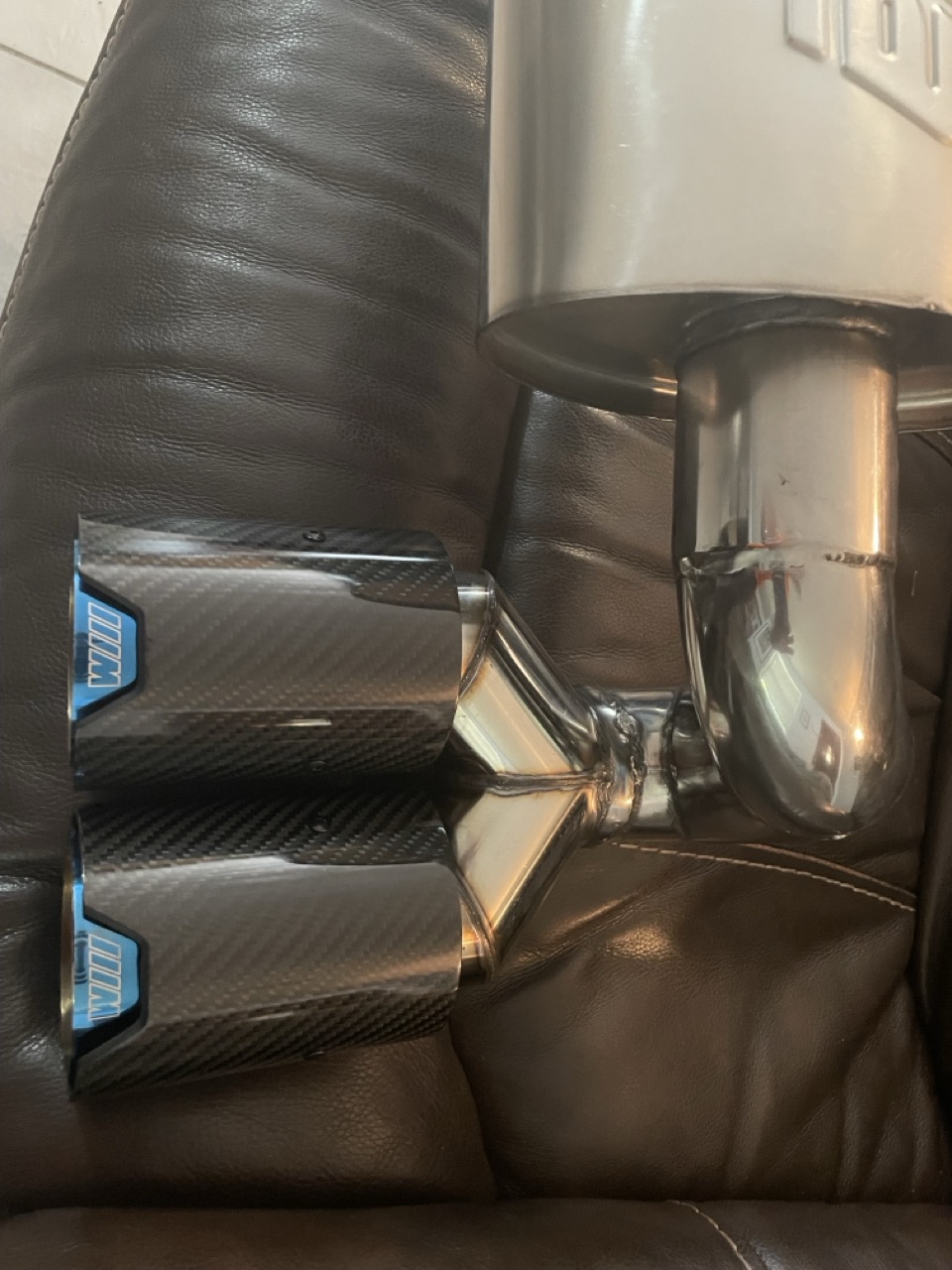

Chad911sc   Working on the Stainless Exhaust today, still need...   Apr 30 2025, 05:22 AM
worn   Working on the Stainless Exhaust today, still nee...   Apr 30 2025, 05:33 PM

Chad911sc   Pics of the exhaust…it being mated up to the MSD...   May 1 2025, 06:35 AM
bajafreaks   Pics of the exhaust…it being mated up to the MS...   May 1 2025, 08:36 AM

Chad911sc   The header is super beefy and very well built for ...   May 1 2025, 09:29 AM
bajafreaks   The header is super beefy and very well built for...   May 1 2025, 09:54 AM
Chad911sc   Yes I built it custom for my application. It take...   May 1 2025, 08:14 PM
bajafreaks   Yes I built it custom for my application. It tak...   May 2 2025, 07:39 AM
