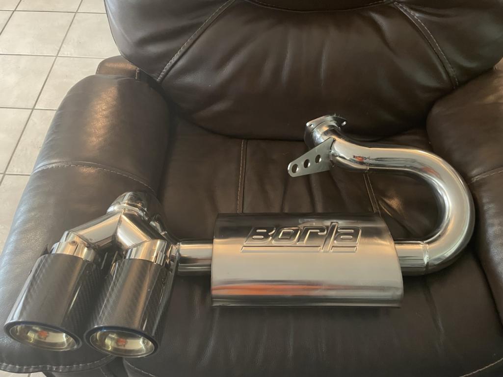

Pics of the exhaust…it being mated up to the MSDS header that I purchased. By the way…very good quality header made right here in the USA. And even better than that, the customer service is top notch! Had a few issues to work through and response was immediate (IMG:style_emoticons/default/biggrin.gif)

I'm looking at the MSDS headers as well, curious on the issues you had and would love to see pics of the exhaust complete. Looking good...

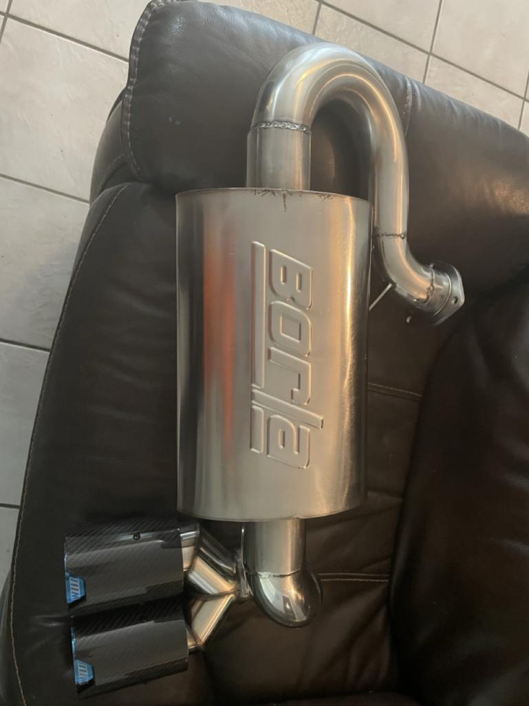

Chad911sc   Working on the Stainless Exhaust today, still need...   Apr 30 2025, 05:22 AM
worn   Working on the Stainless Exhaust today, still nee...   Apr 30 2025, 05:33 PM

Chad911sc   Thanks again for all the wonderful compliments...   May 1 2025, 06:31 AM
Chad911sc   Pics of the exhaust…it being mated up to the MSD...   May 1 2025, 06:35 AM
bajafreaks   Pics of the exhaust…it being mated up to the MS...   May 1 2025, 08:36 AM
Chad911sc   Yes the Pertronix coil already has 3.0 ohms of res...   May 1 2025, 07:39 AM
Chad911sc   The header is super beefy and very well built for ...   May 1 2025, 09:29 AM
bajafreaks   The header is super beefy and very well built for...   May 1 2025, 09:54 AM
Chad911sc   Yes I built it custom for my application. It take...   May 1 2025, 08:14 PM
bajafreaks   Yes I built it custom for my application. It tak...   May 2 2025, 07:39 AM
