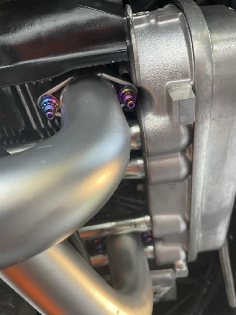

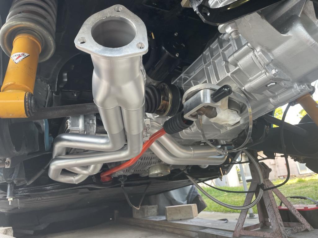

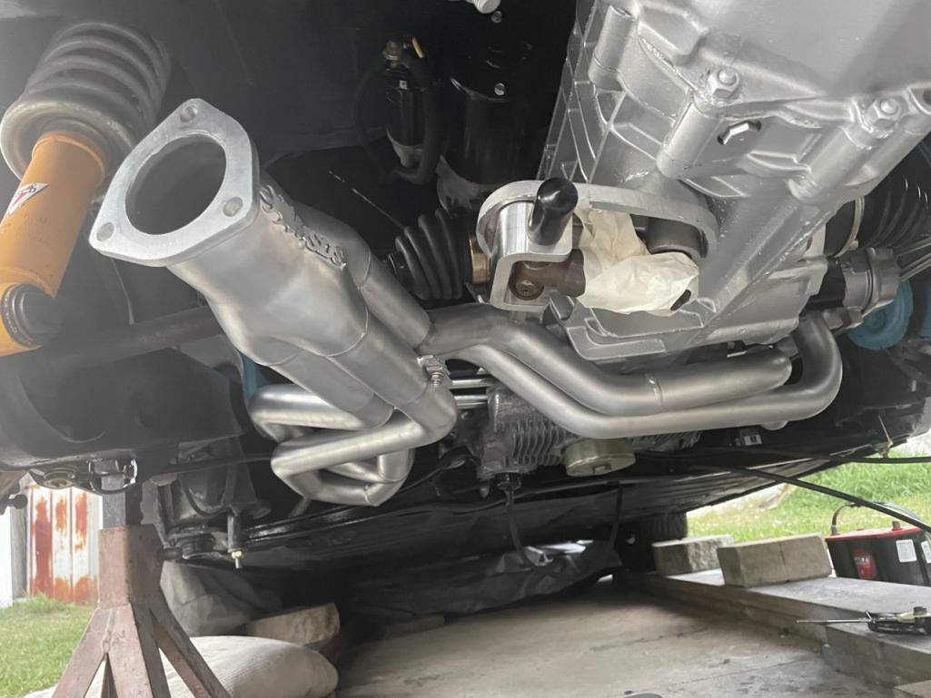

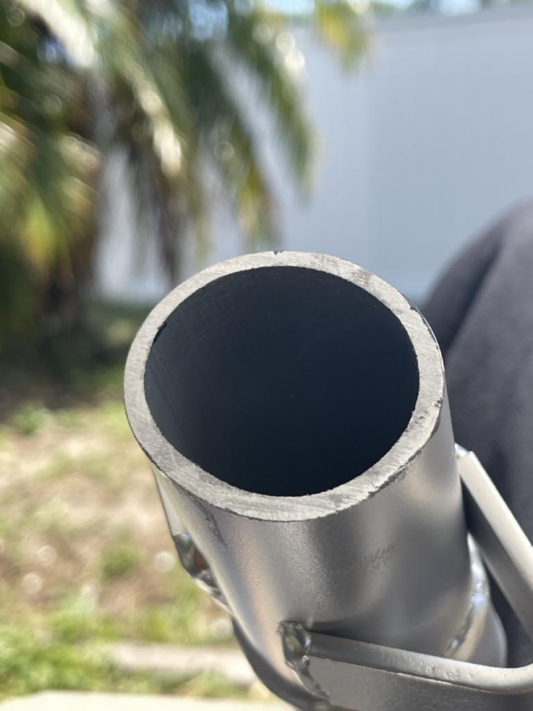

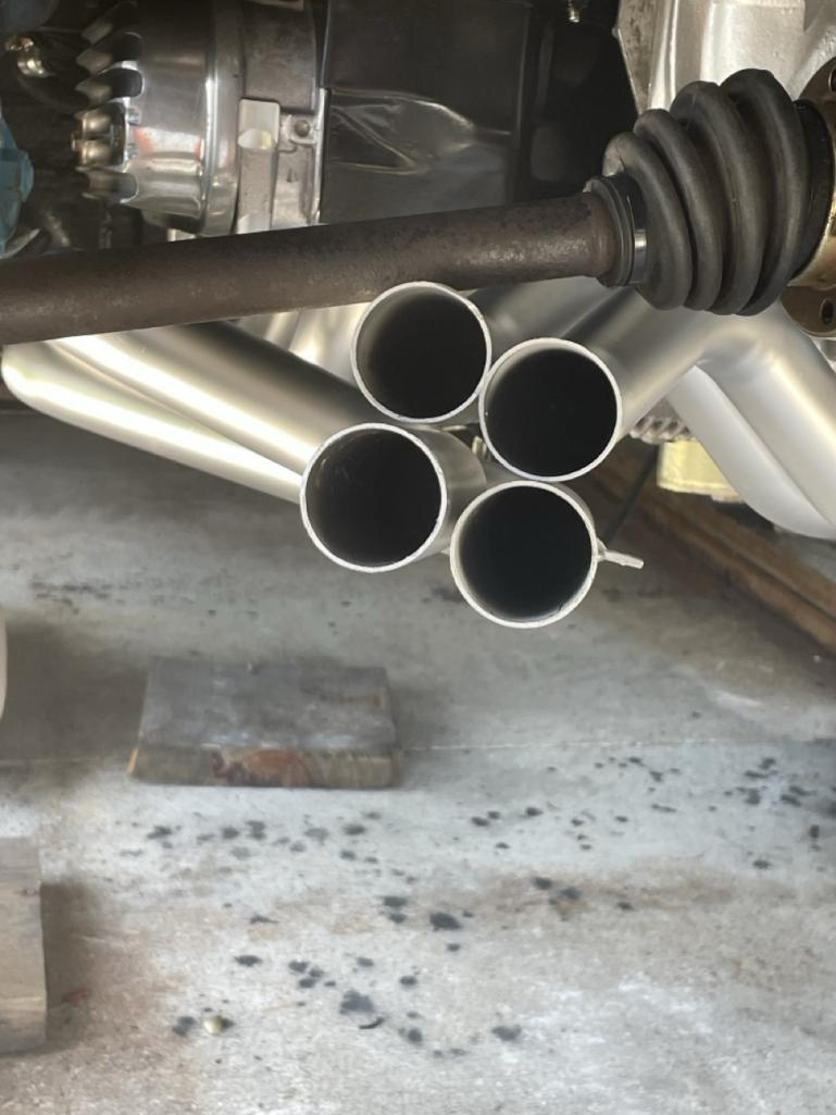

The header is super beefy and very well built for sure. The problem I had was the exhaust pipe from cylinder #4 had a small deflection where the final bend was. I couldn’t see it, and it had me using a weighted big rubber mallet beating on the collector. I couldn’t get it to seat into the 4 pipes. Had about 2 more inches to go, but no matter how hard I hit it, it wouldn’t budge. I contacted MSDS to get some tips on how to get it to seat, and he responded immediately with tips and tricks to get it to seat. I took it back apart and sanded off the ceramic coating that I had applied by them, thinking it was just the coating was too thick. But after reassembly, it still wound not seat. I took it back apart again and that’s when I found the deflection at the last bend. I contacted them again via email, and again they immediately responded with the offer to send me a new ceramic coated #4 cylinder pipe shipped to me for free. He then sent me another email right after that with the idea to hit it with the belt sander to remove the deflection, and that worked perfectly. Two heads are always better than one. This site proves that every day!

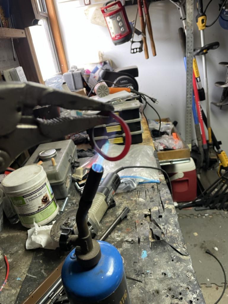

The other thing I had to do, is pretty much what every new exhaust should have done to it, and that is after mounting it and torquing it down, look at your copper gaskets and see if there is any part of the copper gaskets that has no marks on it. Take the copper gasket and lay it on top of the pipe and figure out at what place it isn’t seating all the way and file it down to fit precisely level so that when it’s installed you have the best chance of complete sealing on the first try. And don’t forget to anneal the copper gaskets as well to soften them up.
