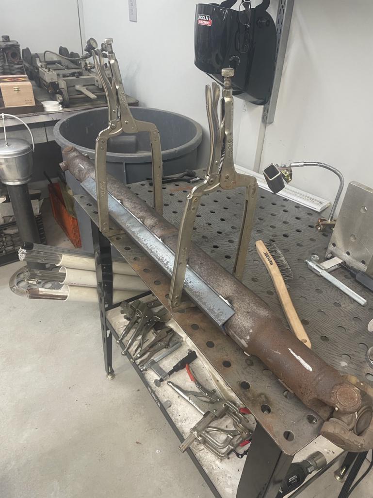

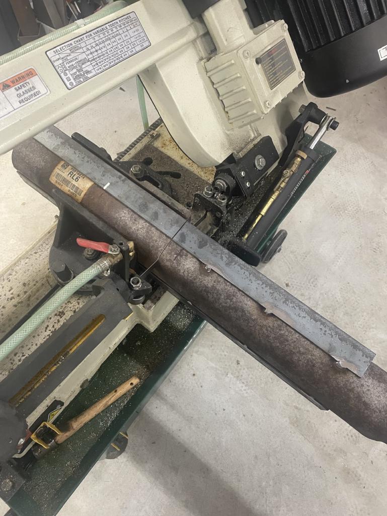

Todays fun was shortening the driveshaft. I tacked two pieces of angle 180 apart onto the stock driveshaft and then cut through the shaft and angle on my bandsaw. The angle will ensure the u-joints are correctly clocked and will help with keeping the shaft straight for welding.

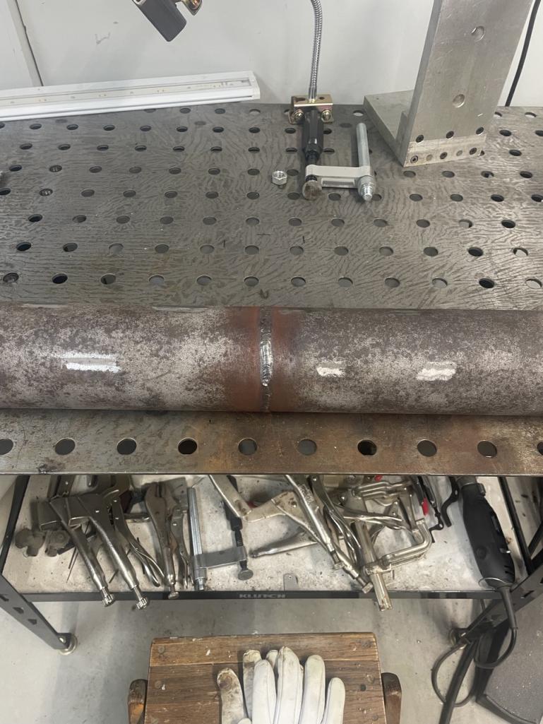

After cutting a 12-1/2” section out, I clamped another piece of angle across the cut sections and welded it up.

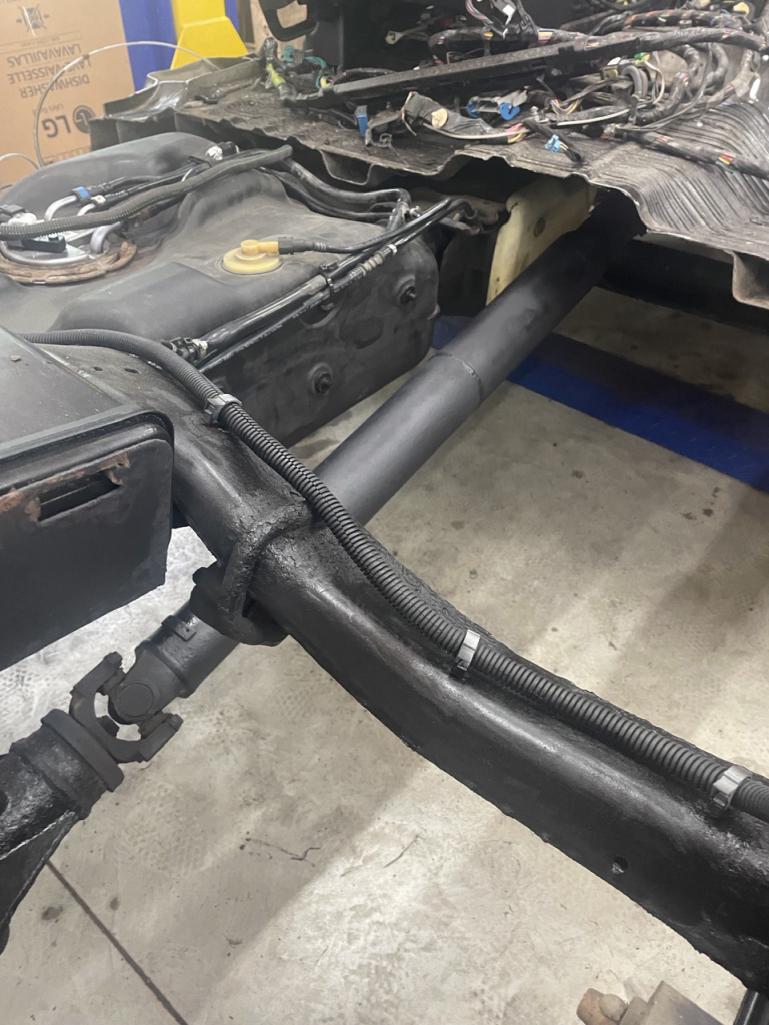

I don’t know how much this effected the balance of the shaft but time will tell. If I have vibration at speed then I’ll get a shaft professionally made/balanced, but I wanted to try this first. I’m betting it works just fine.
