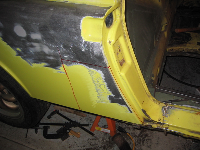

File this under 'while I'm in here' or maybe I should just start a new thread for my 'progress' on the car in general.
I was feeling around in the pass-rear wheel well, and found an unnotived perforation...3min later, I could put my hand in it. What to do? Patch time!

CptTripps   Let's cut it out and see what we have.... Not...   Feb 5 2005, 12:03 AM
CptTripps   Inside the long is amazingly....still shinney meta...   Feb 5 2005, 12:05 AM
CptTripps   I cut everything back to 'good metal' and ...   Feb 5 2005, 12:08 AM
CptTripps   Time to fit a new metal piece in where the old one...   Feb 5 2005, 12:09 AM
CptTripps   I'm still not the best welder, but I'm get...   Feb 5 2005, 12:12 AM
CptTripps   I bought more seam-sealer than I need for the floo...   Feb 5 2005, 12:13 AM
CptTripps   After that dried for a while, I hit it with a thic...   Feb 5 2005, 12:15 AM
CptTripps   And then to the handy-dandy butt weld clamps. (Har...   Feb 5 2005, 12:17 AM
CptTripps   Here's where the battery on my camera died. O-...   Feb 5 2005, 12:20 AM
