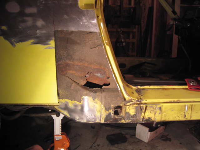

Let's cut it out and see what we have....
Not too bad. you can see the repair the PO made under the batt-tray. THAT fix was done pretty well. I guess they just didn't want to do wha tI just did to finish the job...

CptTripps   File this under 'while I'm in here' or...   Feb 5 2005, 12:01 AM
CptTripps   Let's cut it out and see what we have.... Not...   Feb 5 2005, 12:03 AM
CptTripps   Inside the long is amazingly....still shinney meta...   Feb 5 2005, 12:05 AM
CptTripps   I cut everything back to 'good metal' and ...   Feb 5 2005, 12:08 AM
