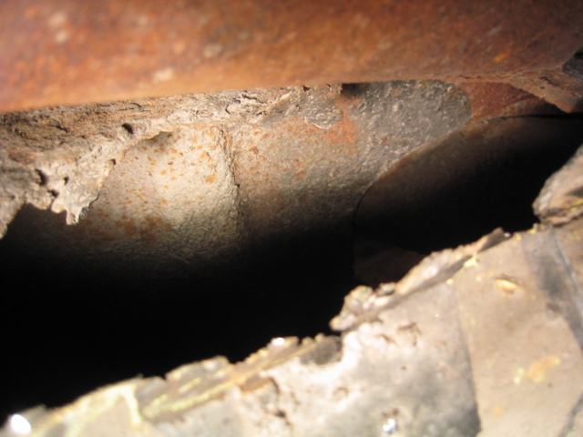

Inside the long is amazingly....still shinney metal! How the hell THAT happened, I'll never know.
There wasn't any flex at all when the car was running (last week) so I'm more concerned with sealing it all up. Attached image(s)
