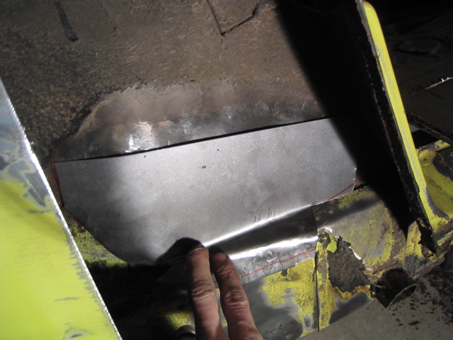

Time to fit a new metal piece in where the old one was...
I used the 16ga metal I'd bought to use for the floor pan.

CptTripps   I cut everything back to 'good metal' and ...   Feb 5 2005, 12:08 AM
CptTripps   Time to fit a new metal piece in where the old one...   Feb 5 2005, 12:09 AM
CptTripps   I'm still not the best welder, but I'm get...   Feb 5 2005, 12:12 AM
