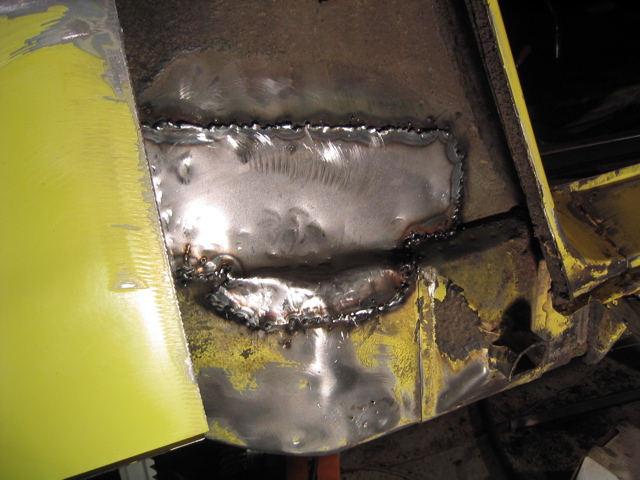

I'm still not the best welder, but I'm getting MUCH better. (This always looks worse when I look at pics.)

CptTripps   I cut everything back to 'good metal' and ...   Feb 5 2005, 12:08 AM
CptTripps   Time to fit a new metal piece in where the old one...   Feb 5 2005, 12:09 AM
CptTripps   I'm still not the best welder, but I'm get...   Feb 5 2005, 12:12 AM
