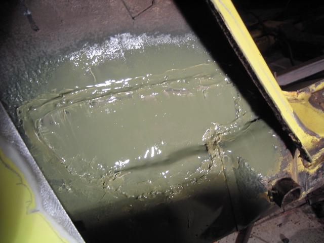

CptTripps   I bought more seam-sealer than I need for the floo...   Feb 5 2005, 12:13 AM
CptTripps   After that dried for a while, I hit it with a thic...   Feb 5 2005, 12:15 AM
