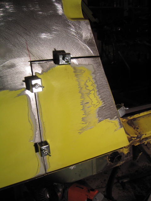

And then to the handy-dandy butt weld clamps. (Harbor Freight...8 for $5!)
When I cut it out, I went on a seam in the door-jam so I'd have a nice place to go back to.

CptTripps   And then to the handy-dandy butt weld clamps. (Har...   Feb 5 2005, 12:17 AM
CptTripps   Here's where the battery on my camera died. O-...   Feb 5 2005, 12:20 AM
