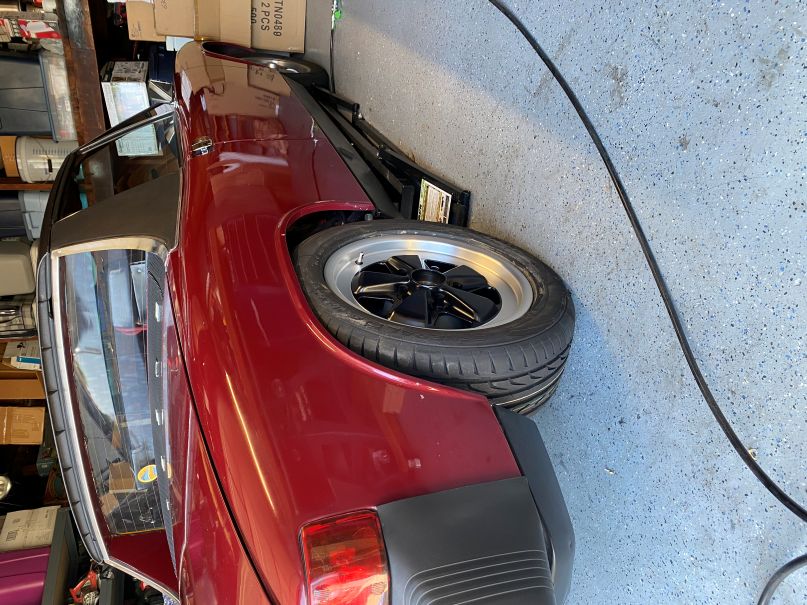

Thought a good "before" pic would be a good way to start this off...

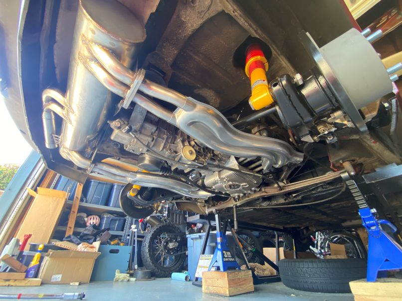

Got the SSI heat exchangers in and the muffler on yesterday with some trial and error to get everything lined up (and still have work to go on some of the warm air duct parts - the passenger side s-tube was not quite lining up...). Also figured out that I somehow ordered the wrong exhaust gasket (oops) so that will need to be remedied.

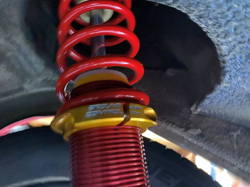

I was quite excited to get the car back on all fours after being in the air so long. I am almost at the max height on the adjustable perches and she seems to sit pretty low and mean. I may have to pull the passenger fender just a bit as the 205's clear but just barely.
Tomorrow’s plan: Reinstall the AAR and airbox, crank up the 2.0, and hope it fires up without issue. If all goes well, I’ll back her into the garage, get back on the QuickJack, and dive into the front suspension.
